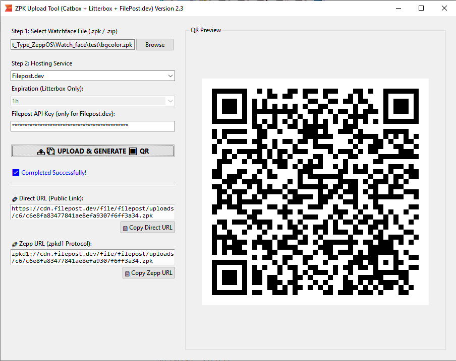

I'd like to update you on file uploading and QR code generation. In Editor Version 18.0 Final of Sasha's Watch Face Editor (for Amazfit watches on ZeppOS) now includes a feature to assist with file uploading and QR code generation for use APP Zepp to install with QR. This option greatly facilitates watch face creators who want to test their watch faces before publishing. Files are hosted on three platforms (littlebox (non-permanent), Filepost, GitHub).
For more information on how to use these features, please see in the program editor on following tabs:
Testing --> Get APIkey (FilePost.dev)
Testing --> instruction (GitHub)

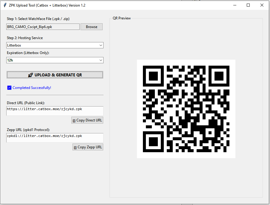

A tool for uploading .zpk files to catbox and generating a QR code for installation in a single step.
( By taw_bip )
viewtopic.php?p=22191#p22191
A tool for uploading .zpk files to catbox and generating a QR code for installation in a single step with GUI.
viewtopic.php?p=22231#p22231

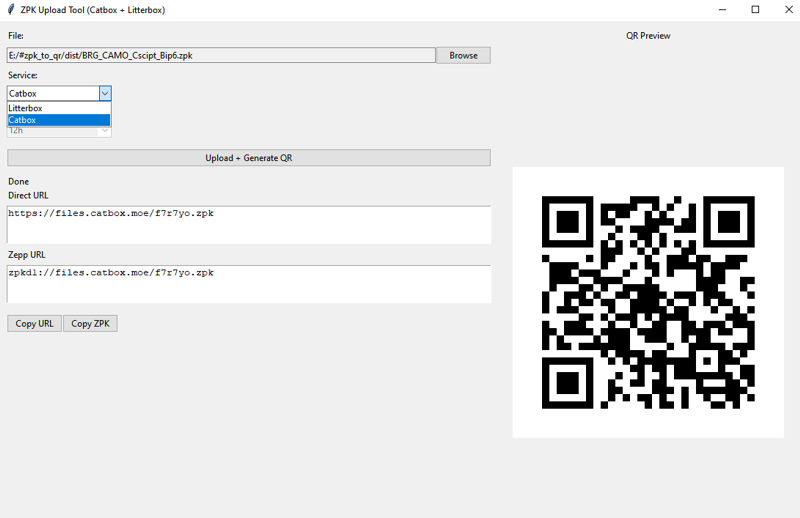

Messaggio da taw_bip »
On my Windows 11 laptop, I used Claude to code up an automation.
Setup (one time)
Install Python from python.org if you don't have it
Save zpk_to_qr.py and zpk_to_qr.bat to the same folder
Open a terminal in that folder and run:
pip install requests qrcode[pil]
Usage
Drag and drop any .zpk file onto zpk_to_qr.bat. It'll upload the file to catbox.moe and open a QR image you can scan directly in the Zepp app to install the watchface.
Allegati
zpk_to_qr.zip
(1.38 KiB) Scaricato 138 volte

Messaggio da asoo »
taw_bip ha scritto: 08 mag 2026, 18:00
Setup (one time)
Usage
This is a useful tool.
However, users need to understand that the files are hosted on catbox's server, and sometimes, if there are many users, uploading and downloading may encounter issues. Therefore, when using this tool, you may need to consider the readiness of catbox as well.
I have created standalone ".exe" file from pyinstaller (zpk_to_qr.py) for those who do not want to install Python, by use original code from owner , So the code and content remain the same as the original.
zpk_to_qr.rar
(15.1 MiB) Scaricato 123 volte
The usage method remains the same as the original.
You can use the command line or drag and drop the .zpk file onto the .exe file.
This file contains minor code modifications for use with litterbox,
which is catbox's non-permanent file hosting service, with file retention set for 1 hour.
zpk_to_QR_litterBox1h.rar
(15.1 MiB) Scaricato 131 volte
Ideal for those who want to test dials and don't need to store them permanently.
Note:
In the future, if Catbox changes its API UPLOD, attached files may no longer work. And I will not modifications will be made if this occurs.

Messaggio da asoo »
I've created a GUI to help upload to LitterBox and CatBox, and generated and displayed a QR code with a URL for user convenience.
I won't be making any further modifications. I've attached the code in Python; feel free to modify it if you wish.
This code uses the following libraries:
requests
qrcode
Pillow
Tkinter (included with most Python packages)
I've included a standalone executable (.exe) in the pack for those who don't want to install Python.
However, this program may not work immediately if CatBox changes its upload API.
If that happens, I will not take any further action.
gui_C_L.rar
(11.3 MiB) Scaricato 115 volte
Update Version 1.2 ( Change layout and some function )
gui_C_L_G_V1.2.rar
(11.3 MiB) Scaricato 121 volte
The original code about upload is from taw_bip:

From my previous post:
viewtopic.php?p=22210#p22210
I've improved the app. You can now select catbox and littlebox, and use Filepost.dev for file uploads and to generate a QR code for installation.
I'd like to thank SashaCX75 for the information on filepost.dev.
If you want to use filepost.dev, you need to register as a member first to receive an API Key for uploading files.
The files you upload will never expire, and you can manage them through filepost.dev.
FilePost.DEV
Download and Preview
ZPK-Tool-Upload_V2.3.rar
(13.78 MiB) Scaricato 129 volte
Update : if use filepost program will be check for the key field; a warning will appear if it's empty.
However, this program may not work immediately if CatBox and or Filepost changes its upload API.
Hopefully, this is another option before SashaCX75's new editor is released.
(This feature is already available in the beta version of the Watch face editor for Amazfit watches on ZeppOS.)
