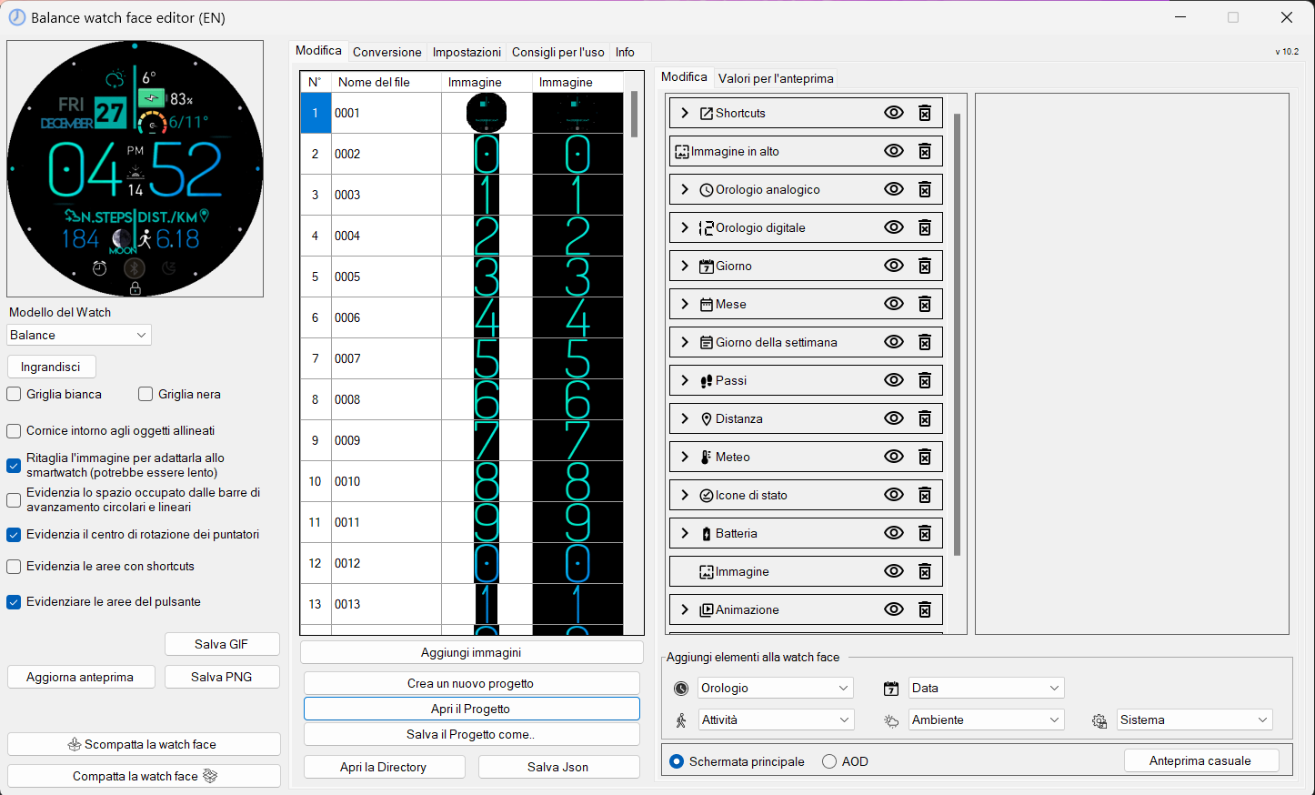

I'll explain better with images:
This is when editor work fine:
as you can see all the images are unpacked and the functions can be modified

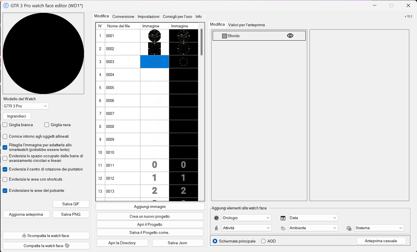

This image instead demonstrates what happens to me with some watchfaces:
Only background is extracted and not all components of the watchface. Where am I wrong?

If you want the correct answer
You should also attach the file you are referring to.
But if I had to guess There could be many reasons.
1. The dial is encrypted in the index file, probably because the author doesn't want his work to be edited. Therefore, normal unpacking will not allow access to the script, so the editor cannot unpack it.
2. The watch face uses a custom script to create and the custom script does not meet the editor standards, or Or the watch face was created with another editor and the script creation does not follow the format of Sasha's editor. so unpacking may not be possible or only partially possible.
3. The watch face was created with a newer version of the editor more than you are using .
In this case, unpacking may work, but may not handle new elements added in the new editor version.
If you want to edit The aforementioned dial You can do it like this:
1. In the case where the script is coded You must try contacting the owner of the work. for him to do it for you
2. In the case of custom script, you can view and edit the script by looking at the index.js file.
3. In the case of a newer version, you just update your editor.
4. If you really want to edit that watchface, you can use the image after unpack and bring it to make new by yourself

Thanks Asoo....
In my opion the option correct is number one :)
This is wathface:
https://amazfitwatchfaces.com/gtr/view/38176
I see that all watchfaces of this autor is locked.
