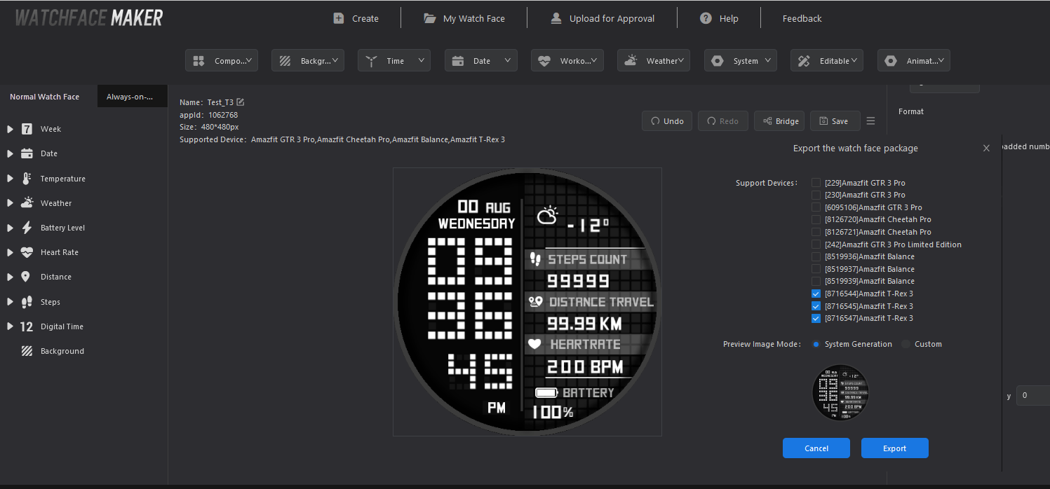

Watchface maker.png (132.52 KiB) Viewed 13568 times
Test_Trex3.zip
(148.96 KiB) Downloaded 115 times
This is an example watch face for T-Rex 3 created using https://watchface.zepp.com (WatchfaceMaker), the official editor for Amazfit series. As far as I tested, the watch face created for T-Rex 3 can be used with Amazfit Balance, so I guess Amazfit Balance watch face can be used with T-Rex 3. However, I am not sure the "Balance watch face" is fully compatible with T-Rex3 or not .
Posts: 820
Joined: 26 Oct 2019, 15:18
Been thanked: 1029 times
Post by SashaCX75 »
https://watchface.zepp.com (WatchfaceMaker) creates two different packages for T-Rex 3 and for Balance. The images in them are also different. But the way of encoding images in them is similar. Perhaps T-Rex 3 does not support ARGB images, so some of the images for it were packaged differently. Only watch owners will be able to fully check the compatibility of watch faces. But I think there should be no problems.
