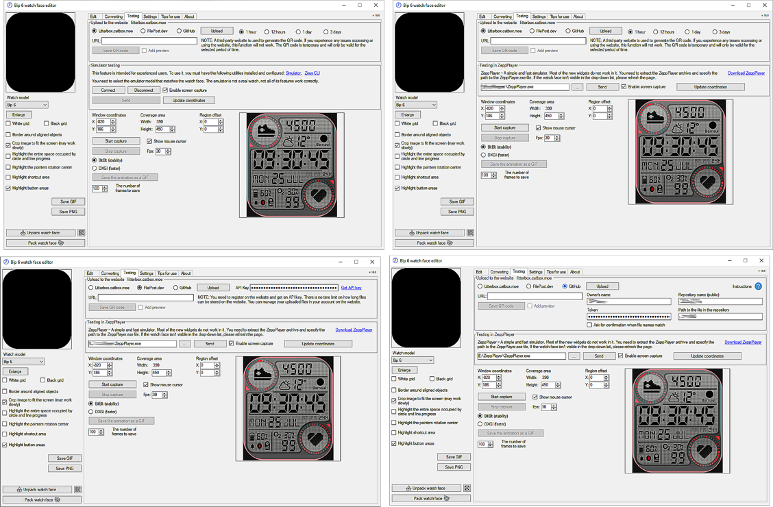

I'd like to update you on file uploading and QR code generation. In Editor Version 18.0 Final of Sasha's Watch Face Editor (for Amazfit watches on ZeppOS) now includes a feature to assist with file uploading and QR code generation for use APP Zepp to install with QR. This option greatly facilitates watch face creators who want to test their watch faces before publishing. Files are hosted on three platforms (littlebox (non-permanent), Filepost, GitHub).
For more information on how to use these features, please see in the program editor on following tabs:
Testing --> Get APIkey (FilePost.dev)
Testing --> instruction (GitHub)
Editor Version 18 also includes a feature for capture page of simulator , but I won't elaborate further here as it's not relevant to this topic. However, you can find more details in the program.
