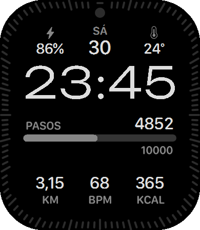

I hope I am heading to the appropriate subforum. If not, I apologize. I have a problem with a watchface I created for my Amazfit GTS 4. I am using the SashaCX75 app version 12.2. I have created an element that is distance. But it does not match the data that my smartwatch provides me. It is a smaller amount. I think it is in miles, when I want that data to be in km. For the creation of the element I do it using "Value by source", not "Numeric values". I have looked at application settings, but I cannot modify that. Also in the "index" file, in the "watchface" folder to try to edit it. But it doesn't seem to be possible either. I have searched the forum, but I have not found anything or I have not known how to search properly.
Is there a way to have the distance information not in miles, but in km?

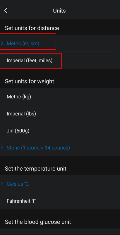

If I understand your question correctly, I think the units displayed on the watchface are based on the settings in the Zepp App.
It is not defined in the watchface's script.
In the script, it only defines which characters to display the numbers.
And ,If zepp is setting unit KM, which image will be used to display the units, and if it is MI, which image will be used to display the units.
If you set it to KM in app zepp, the watchface will display the distance as KM. Conversely, if you set it to Mi on the watchfce, the distance will be displayed as Mi.
Setting unit on App Zepp

Thank you very much for responding. In the Zepp app settings it is in Km, not Mile. I don't know why in the watchface that I created the distance traveled is less than what my smartwatch actually tells me. Once the created watchface was installed, I restarted it. But it still shows me a distance less than the real one. I think the distance shown on the created watchface is in miles.

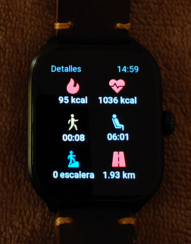

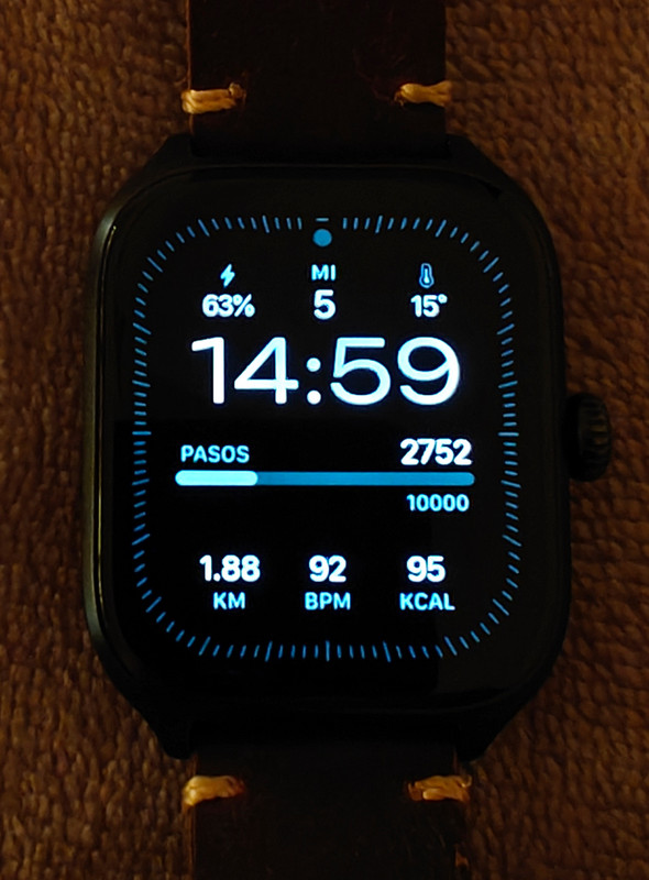

The truth is that I don't understand it. I have the Zepp app updated. I have cleared app cache. The firmware of my GTS 4 is updated. I have restarted it several times. And the watchface data created in relation to distance does not correspond to reality in km. The watchface data is not mile either, because it does not match mile. It is simply not correct. I attach photographs.

It seems to be a specific feature of this model. You can try to use ‘Numeric values’ image set instead of font. It might help.
