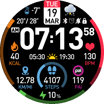

Sasha, help me :)
Please is it possible to assign KM or MILES units (2 png files) under the numerical value? The program allows only to the right of the number. I have to put it as in the attached picture.
Posts: 820
Joined: 26 Oct 2019, 15:18
Been thanked: 1029 times
Post by SashaCX75 »
@hemendex
This is not officially supported. But I can suggest a way to try to do it.
Make the image of digits wider (about as wide as 3 digits). The digit itself should be on the right side of the image.
Make the image of units of measurement higher by about 2 times. The units of measurement should be placed in the lower left corner. Set the negative space to be about the size of 2 digits.
