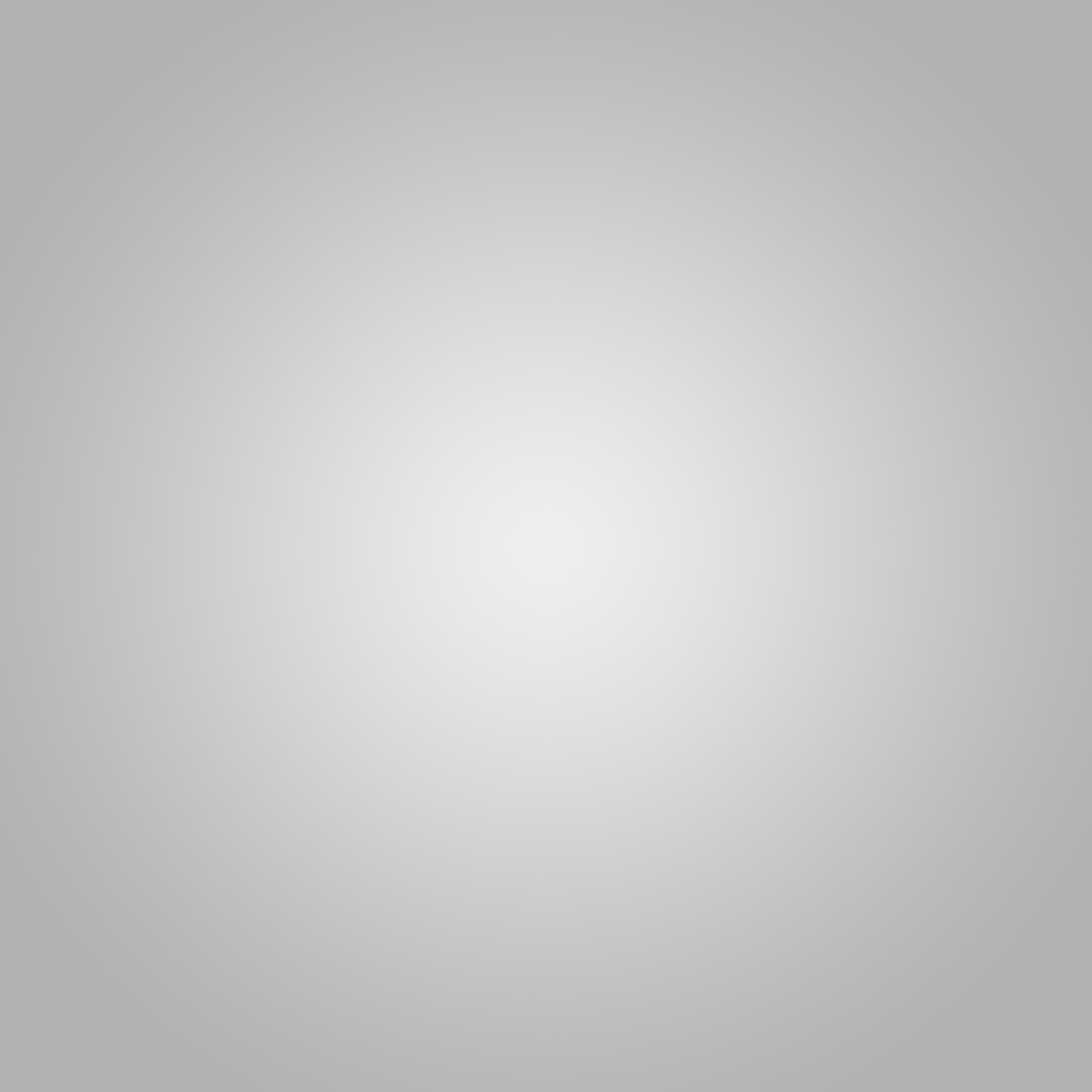

This is original gradient image create with photoshop:

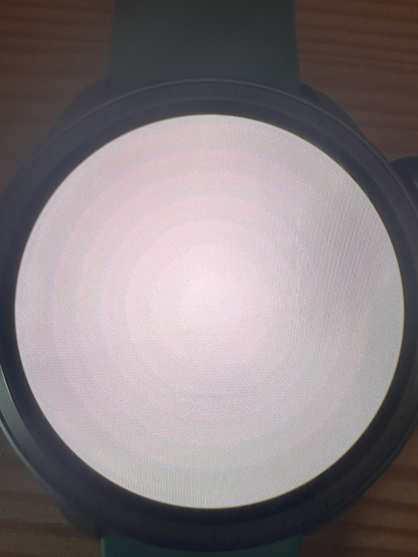

and this is visualization of image on Balance:
as you can see, gradient shades are not managed. There are a series of concentric circles, as if the image were in 4 bit or in .gif or .tif format

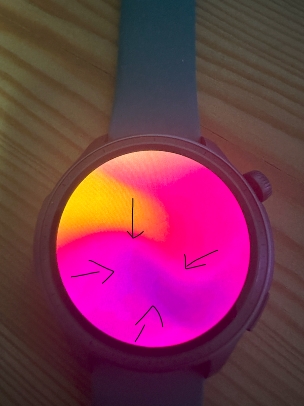

Nope, bro.
I'm trying to set a background for my watchface that has a gradient
The image I attached was built with Photoshop to be displayed on the Balance as a gradient.
But it doesn't display correctly on the Balance display
It appears like this on the watch:

LOOK:
installing your image on balance, it appears grainy
The balance dont manage correct gradient that you have create

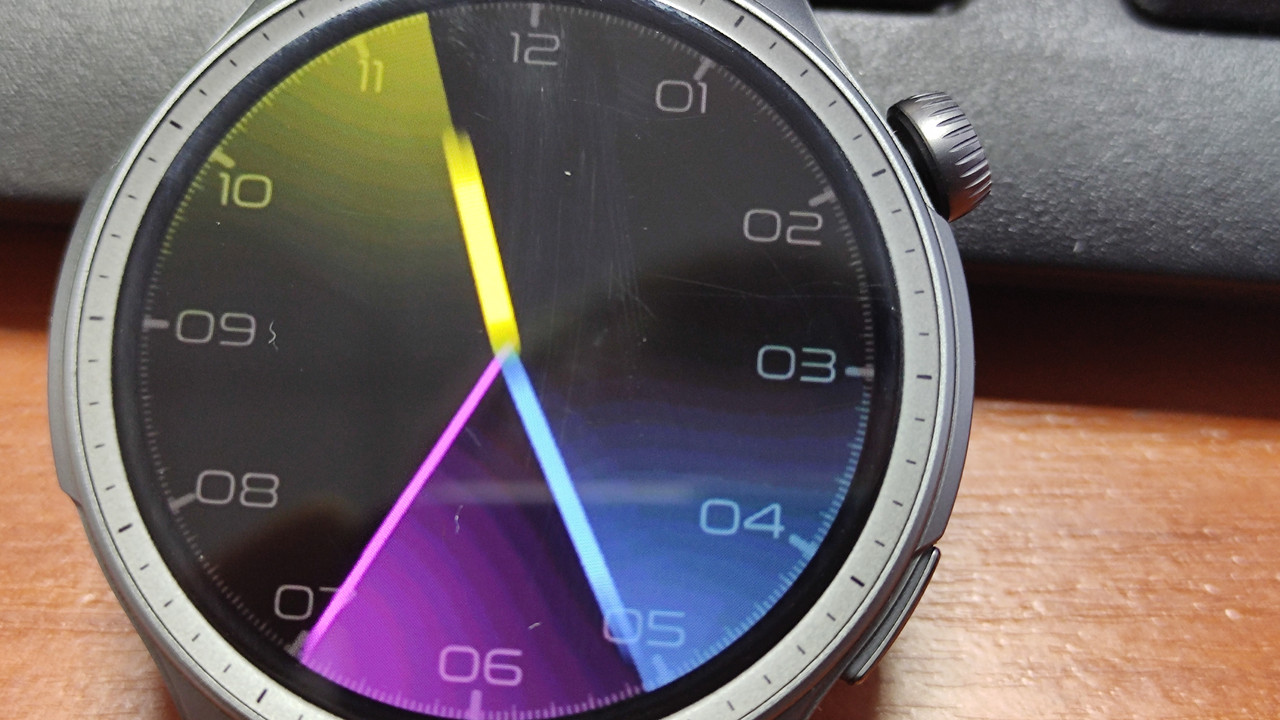

screenshot
Here is a photo of the watch and a screenshot taken on the watch (not in the editor). The photo shows more artefacts than the screenshot. This indicates that the screen cannot display smooth gradients. However, with my eyes I don't see any problems in the display on the watch.
