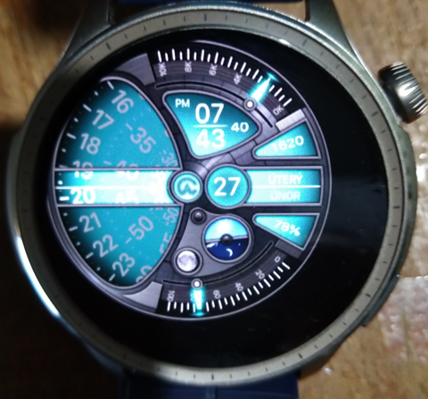

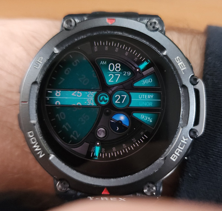

I have a T-Rex 2 and thought only watchfaces with the same resolution would work on it but I have discovered that watchfaces for quite a few watch models with different resolutions will work.
So far I've been able to install watchfaces for Balance, Falcon, GTR4, GTR3 Pro and Cheetah Pro watches without issue. I've even installed square watchfaces from the Amazfit GTS 4 mini but they're not a great fit.
Some people like T_5 use a filter to prevent installation on "unsupported" devices but that's been the only obstacle I've found so far.

If correct, I must say Watchfaces based on ZeppOS and using the same image encoding as the Trex-2 can be launched on the Trex-2, but the problem is that the watchface size may not fit on the Trex-2 and if the watchface has motion and rotation animations. that uses the script of Zepp OS 1.0 when used with Trex-2 which now uses zeppos 2.x will cause the Animation mentioned above to not work including Smooth analog seconds if the dial is Type 1 which is the format of Zepp OS 1.0 Will result,it not working as well.taw_bip ha scritto: 26 feb 2024, 19:34Spoiler

Aside from the non-round watchfaces, the ones I have tried worked well. It's interesting that the watch will automatically scale up or scale down the watchface to make it fit the screen.

Please give an example of a dial that automatically scale up or scale down for me. I'm interested, don't look at the script for that dial.taw_bip ha scritto: 27 feb 2024, 12:00Aside from the non-round watchfaces, the ones I have tried worked well. It's interesting that the watch will automatically scale up or scale down the watchface to make it fit the screen.
Because as far as I know, I have never encountered a dial like that, except that the dial is the same size, for example Trex2 and GTR3 and T-Rex Ultar are the same size.
Anyway, please help me, I want to study the scritp of that dial. Because I think it very useful.

I don't think it's a script in the dial. I think it is a function in the watch. As I said before, the only round watchfaces on newer models that did not work were the ones by T_5.asoo ha scritto: 27 feb 2024, 12:18Please give an example of a dial that automatically scale up or scale down for me. I'm interested, don't look at the script for that dial.taw_bip ha scritto: 27 feb 2024, 12:00Aside from the non-round watchfaces, the ones I have tried worked well. It's interesting that the watch will automatically scale up or scale down the watchface to make it fit the screen.
I tried these Balance watchfaces and they loaded properly:
https://amazfitwatchfaces.com/balance/view/241
https://amazfitwatchfaces.com/balance/view/173
The following Cheetah Pro watchface worked. It was the only one I tried.
https://amazfitwatchfaces.com/cheetah/view/43
I tried this Falcon watchface and it worked:
https://amazfitwatchfaces.com/falcon/view/57
This GTR4 watchface worked:
https://amazfitwatchfaces.com/gtr/view/38064

If I'm not mistaken several such watch faces were made by leXxiR. But such watch faces do not use images. Text is displayed using font, other elements are drawn by code. All sizes of elements are bound to the screen size.asoo ha scritto: 27 feb 2024, 12:18Please give an example of a dial that automatically scale up or scale down for me. I'm interested, don't look at the script for that dial.
All watch faces that use images are made to fit a specific screen size. But sometimes it is not immediately obvious that the watch face is not the right size. This depends on the design of the watch face.
