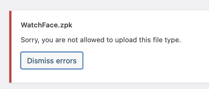

Hi, need more help, if you agree and you have time.
I have opened a altervista account. What is the way to load my file in altervista ? Is it in media library ?
How do you obtain the zpk file ? By changing the file extension in file explorer ? Is it before uploading in altervista ?
Do you need to uplaod zip file AND zpk file in altervista ? When I try with zpk file, altervista tells me I'm not allowed to load files with this extension (zpk).
To sum up, I'm lost ...
In advance many thanks for your help.

Stephthouv
- Posts: 15
- Joined: 10 Jul 2022, 11:05
- Location: Montpellier
- Has thanked: 7 times
Actually there are 2 types of altervista accounts. One is a blog, the other allows theoretically to upload files, whatever the extension of the file.
But despite I used a vpn to change my country, impossible to subscribe to a "file server" profile: unavailable in my country (I tried several countries).
After several attempts, I gave up....
Stephthouv
- Posts: 15
Rename it in windows explorer before uploading it in altervista portal

Grazie per la risposta, purtroppo non riesco a caricare il file, risponde che il file non è una watchface.
Thanks for the reply, unfortunately I can't upload the file, I reply that the file is not a watchface.
