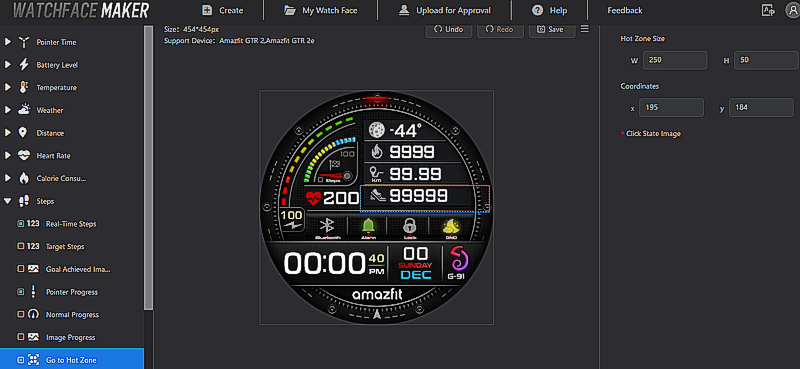

AmazFit_Watchface_Editor_2 is real editor for GTR2 format and GTR2 not have shortcuts function so editor can not and any shortcuts.
But the official editor ( https://watchface.zepp.com/create )has a shortcut part.
Ex. ( shortcut in step)
Imagem
Código: Selecionar todos
"Activity": [
        "Type": "Steps",
        "PointerProgress": {
          "X": 170,
          "Y": 165,
          "Pointer": {
            "Coordinates": {
              "X": 14,
              "Y": 70
            "ImageIndex": 58
          "StartAngle": 263.0,
          "EndAngle": 371.0
        "Shortcut": {
          "BoxElement": {
            "TopLeftX": 195,
            "TopLeftY": 184,
            "Width": 250,
            "Height": 50
          "ImageIndex": 59
        "Digits": [
            "CombingMode": "Single",
            "Digit": {
              "Image": {
                "X": 252,
                "Y": 188,
                "MultilangImage": [
                    "LangCode": "All",
                    "ImageSet": {
                      "ImageIndex": 41,
                      "ImagesCount": 10
              "Spacing": 1
testshortcutonstep.bin
(491.54 KiB) Baixado 464 vezes
But the last time I tested It doesn't work either.
and now I'm not using GTR2 so can't test if it works now or not.
AmazFit_Watchface_Editor_(GTR47ToGTR2) can add shortcuts because it use script GTR47mm to make GTR2 . it's not a real GTR2 format and have some element not work on the GTR2 although it can be displayed correctly on the editor program but some element not work on real device.

https://amazfitwatchfaces.com/gtr/view/28361
but my new creation doesn't work so I haven't uploaded yet - pls see attachement
and 'course I upload first bin about I talked - KiteCat
If I'm not mistaken, GTR2 can't use System fonts and custom fonts at the same time . In this case, your problem might be that you are showing Digital time in seconds with custom font and System font at the same time, which might be the reason for the problem you are having. You only have to choose one or the other.

Mensagem por RTMhun »
this can a correct way for sollution
I'll Try!!!
THANKS
RTMhun
Mensagens: 21
Registrado em: 29 Set 2022, 05:05
Localização: Hungary
Been thanked: 11 times
Contato:
OOOOUUUHH!
it works!
my some projects occures same errors
so sure same solutions wait for me
many and more thanks
you made my day!
