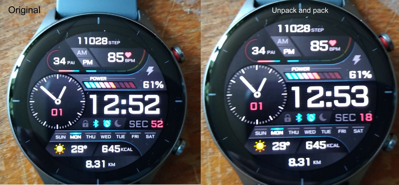

Test py_amazfit_tools-GTR2_v0_2.zip ( Fixed Images loss when packing bin file).
Now Program can pack and unpack normal .
Imagem
Thank bigdigital.kov for fixed the program.

Test Version 0.2
https://i.postimg.cc/T3Ch92D0/test.png
- Test on GTR2e , it's work normal
