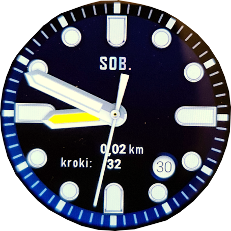

I made, or actually converted into Polish, my first watch face for the GTR 2.
I did it thanks to the information posted here by "bigdigital.kov" and also thanks to a lot of help from "joebar78".
This is a remake of the "Classic Touch Blue" dial placed here by "Do_bro" and, as he wrote, created by "Kivan".
I hope that they will not be offended when the Polish version of this shield for GTR 2 appears here. I just wanted to show that the advice published here is effective. I wrote to "Do_bro" about this but he didn't reply. If there is such a wish, I can delete this watch face.
I will publish it under the original name with the addition of PL, which is "Classic Touch Blue PL". I am enclosing a photo of the final watch face. Unfortunately, the colors are slightly different from the actual ones. In fact, this watch face is prettier (it looks better on a watch).
By the way.
I had to take a photo of the watch to send the final image.
Does anyone know of any other way besides the tedious drawing of a working watch face?

I made a second watch face for the GTR 2. This time I really "carved" it by designing it "by hand".
Here you can see it and read about it in English and Polish, and of course download the BIN file.
Link: https://amazfitwatchfaces.com/gtr/view/12120

I do not have access to the HUAMI online tool. I applied for access more than 7 days ago and to no avail. When I try to enter the website, I get the message "You registration application is under review".
As for the display of icons: alarm and bluetooth, I coped with the alarm icon. Unfortunately, the bluetooth icon is not displayed on the watch face, even though bluetooth is turned on and the smartphone and the watch "see" each other. In the applications:" Zepp" and" "Notify for Amazfit" my GTR 2 is visible. I don't know what about this bluetooth icon?
