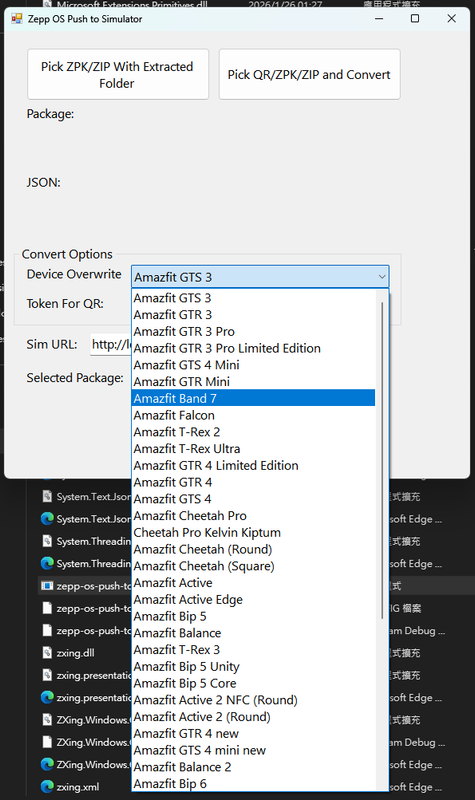

Thanks for SashaCX75's suggestion! Adding a menu to choose the watch model seems very useful for helping users push their packages to the simulator more easily. However, I need to find a simpler way to retrieve the device source table from the official documentation to generate that menu more efficiently.
The purpose of step 2 in the C# port's README is to have the user fill in the token sent when the official Zepp app scans the developer QR code. This allows users to download the output package generated and uploaded by the official CLI workflow (such as the "zeus preview" command). I will update the guide in the future to make it easier to follow.
Complete usage instructions can be found in the JavaScript version's README; I've included a note directing users there for the conversion process. Regarding image conversion, my solution uses your converter to turn the processed images back into viewable PNGs. I believe providing an exported package that includes the original PNG assets is more convenient for users trying to push their watchfaces to the simulator.

Sorry for being too busy for the last two months :)
I modified some functions and improved the README. Now the program is easier to use, and has more complete instructions to follow, making it easier to upload the package to the simulator.
Now the program will depend on the devtable.html file that I grabbed contents from the site:
https://docs.zepp.com/docs/reference/re ... vice-list/
The program will recognize the table and save the list includes device names and device sources in the memory.
And if people pick the zpk file, the program will read the JSON in a certain directory automatically, and lookups the device name by the device source number.
You can read the new README for more detailed instructions:
https://github.com/Bob-YsPan/zepp-os-pu ... mulator-cs

YsPan
Messaggi: 10
Iscritto il: 29 mar 2021, 14:30
Località: Taiwan
Been thanked: 7 times
Messaggio da YsPan »
SashaCX75 ha scritto: 29 giu 2026, 14:39
@YsPan I didn’t receive a reply from you, so, based on your code, I’ve added a function to the editor to synchronise with the simulator. I’ve also added a few more features to the latest version of the editor to interact with the simulator.
https://upload-cdn.zepp.com/zeppos/devk ... vices.json
I’d recommend updating the list of devices from here. It’s more comprehensive here and is usually more up to date. This format is also easier to work with, and you can update it automatically when the app starts.
Thanks to the suggestion, it seems that source is more easier to parse, and I can even write the HTTP request to automatically grab the newest file without making any additional cleanup.
YsPan
Messaggi: 10
Località: Taiwan
I changed the device table source for my application, and grouped it by the product name field. Now it will auto-fetch the newest device table from the internet :)
