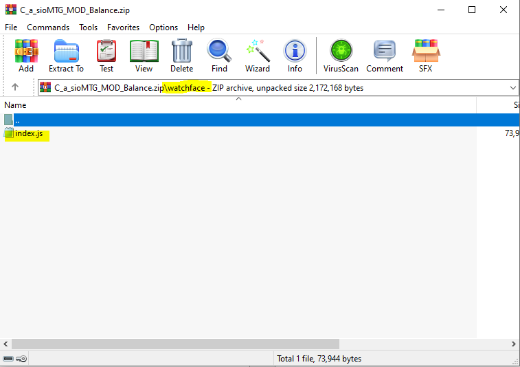

Posts: 2167
Been thanked: 2086 times
g-rex69 wrote: 17 Mar 2026, 08:24
What is the "index.js"?
are u talking about the prime "json" file in the root folder or the files inside the JS folder.
so i understand i need to use the UglifyJS before im packing a watchface to zip file
"index.js" is not included in the project's boundary package.
To implement UglifyJS, you need to work with the index.js file. This file is located in the watchface .zip file that you received after unzipping. After unzipping, you will see index.js in the watchface folder. Then, unglify that index.js file and place it back in the same .zip file.
Preview
In short, Uglify is do on the index.js file located within the watchface (.zip) file.
It's not done during project creation. You must first create the watchface file to obtain the .zip file, then unzip and Uglify the index.js file that inside the .zip and zip it into its original location.
