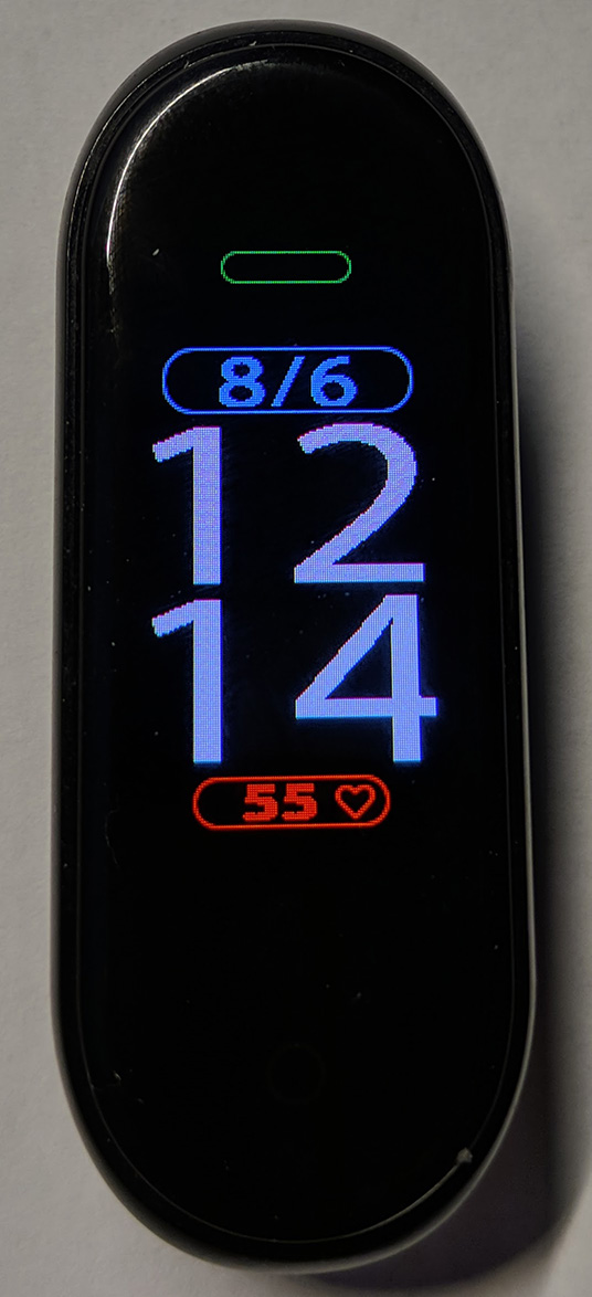

terminal
Mensaje por terminal »
I'm having trouble with the preview not matching what shows on the watch itself. Everything looks fine in the preview, but on the watch, the battery bars, weekdays, and flags for DND, BT, and lock are missing. Any idea what's going on here?
Here's the preview, directly from the tool, v1.38:
Clarity 2.0_packed_animated.gif (97.32 KiB) Visto 22065 veces
Here's what actually shows up on the watch:
messed up clarity2a.jpg (121.21 KiB) Visto 22065 veces

terminal escribió: 06 Ago 2019, 19:34
Try changing Y coordinates to 1 instead of 0.

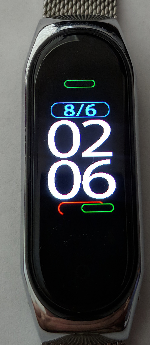

terminal
fprietog escribió: 06 Ago 2019, 20:16
Thx for the hint, but it didn't change anything.
Also, it's odd that rebooting the device messes up the display even more:
messed up clarity2c1.jpg (231.69 KiB) Visto 22057 veces
lvpokka
Mensajes: 178
Registrado: 07 Jul 2019, 20:22
Ubicación: L1
Has thanked: 19 times
Been thanked: 152 times
Contactar:
Mensaje por lvpokka »
[mention]terminal[/mention] wtf? Weekdays should be 21 in stead of 7... first seven is China next 7 is Norml China and next 7 images is english or all other languages
Battery json object missing first block
"BatteryConfig": {
"BoxWidth": 0,
"Alignment": 0,
"Order": 0
+ battery images count is 9 not 10
... never mind
you have ALLOT of errors, please take different or read manuals how to work with jsons
This is not a good topic for your question, create separate one
