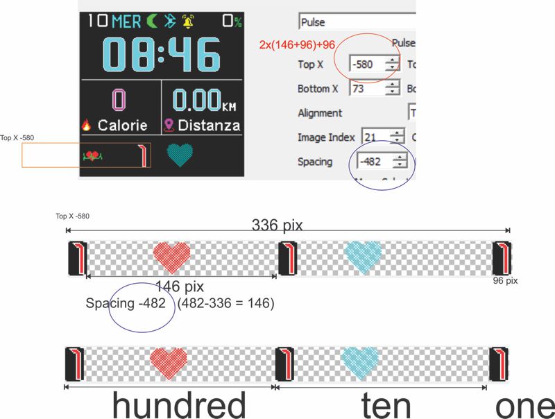

Re: Is it possible to have heart rate icons?
BTW, what editor are you using that is displaying the spacing information in the image above? I've been using that online tool, and it doesn't look like that. Since you are the watch face expert, are you using a better/different tool?
Bip WF Editor by ilGruppoTester
https://www.mediafire.com ...
