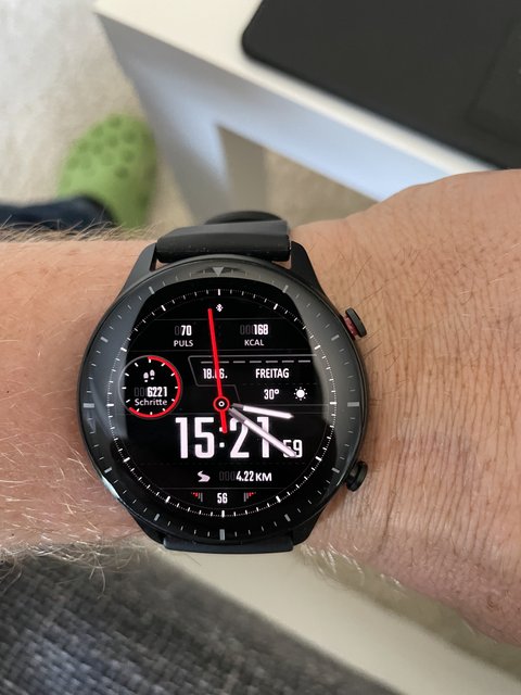

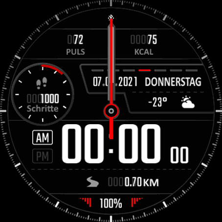

Why the year and the weekdays Indicator isn‘t showing on the watch? In the gif it is there but on the watch Not.
in editor it looks this way
Imagen
on the watch like this
Imagen
Avatar de Usuario
Mensajes: 820
Ubicación: Ukraine
Been thanked: 1029 times
Contactar:
Mensaje por SashaCX75 »
civicdriver80
Due to the lack of information provided, one can only guess about the causes of the error. I can assume that you are converting the dial. And the description for the converter says that not all elements can work.
civicdriver80
Mensajes: 9
Registrado: 02 May 2021, 09:19
Ubicación: Germany
Contactar:
Mensaje por civicdriver80 »
Yes it‘s converted from the GTR watch i have before. So i have to Write it new if i want the 2 things get to work?
