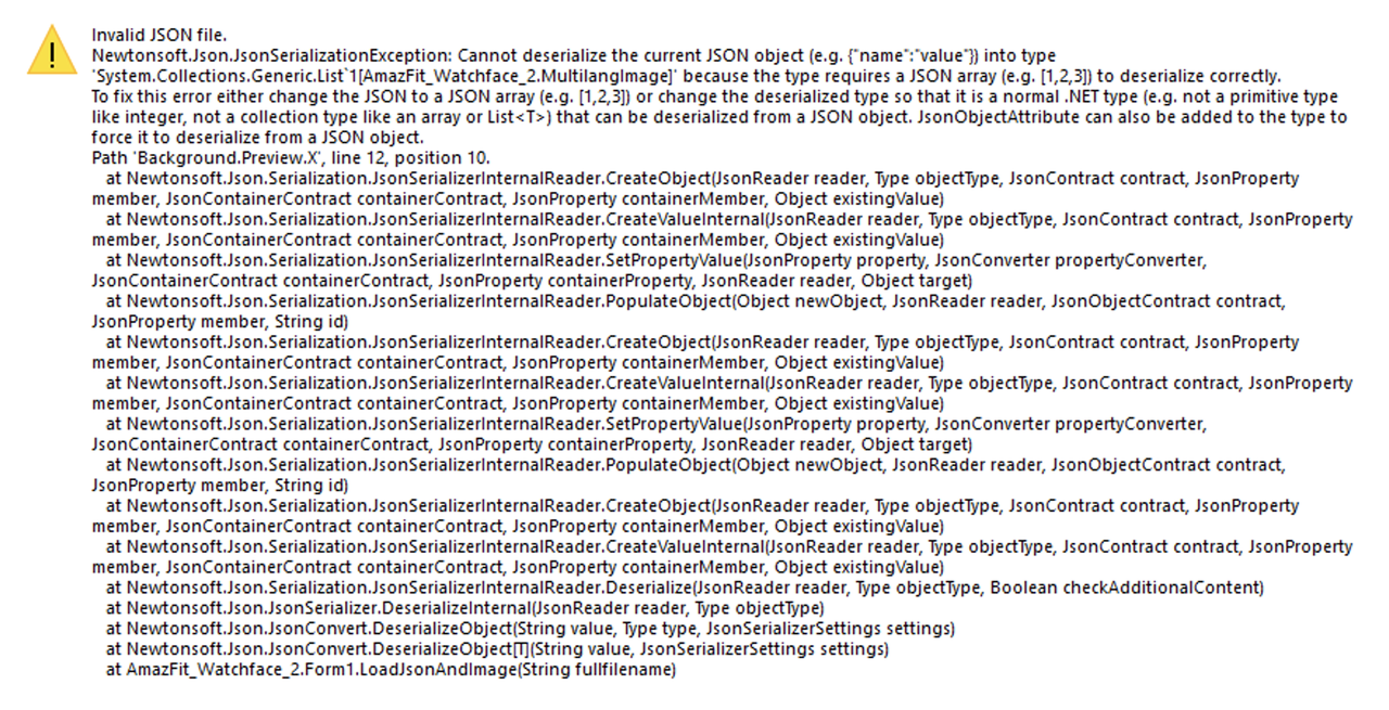

I was trying to edit this with the GTR 2 editor (AmazFit WatchFace editor 2 for Windows), but it is giving me "unparsable" error. My goal is to customize the AOD screen, can you also help me with that?
I just tried to unpack this bin, but it gives me this exact error -
"PNG file numbering must start at 1"
and then this error [attached screenshot]

That BIN is not BIN GTR2 , it is BIN convert from GRT1 .json is still GTR1 Format if you want to edit you must to use "AmazFit_Watchface_Editor_(GTR47ToGTR2)"prostogi ha scritto: 19 mag 2021, 05:00Spoiler
Thank you so much for sharing this @asoo
viewtopic.php?p=8844#p8844
if you want to use "AmazFit WatchFace editor 2 " for modify you must make it new all , you can use only picture to create or modify , can not use .json for this BIN to create or modify
