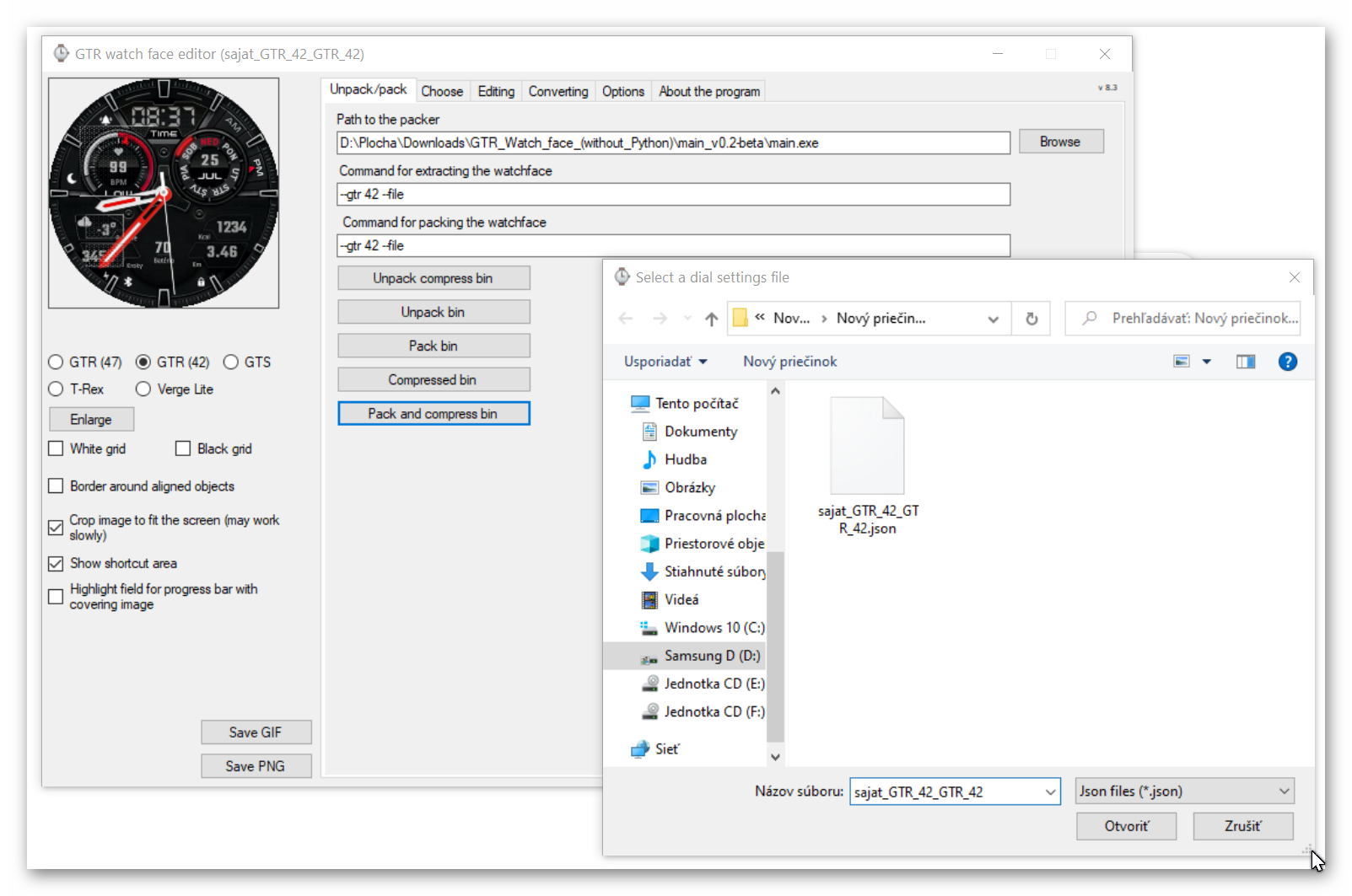

Rafi87
Posts: 53
Joined: 25 Jul 2020, 09:15
Location: Slovakia
Post by Rafi87 »
Hi
I modified the existing dial and when I want to pack and compress the BIN it will open a window for me and instead of SAVE it is there that open a JSON file
how do I save the modified dial to a BIN file?
Ashampoo_Snap_sobota 25. júla 2020_20h38m13s_001_.png (374.15 KiB) Viewed 23370 times

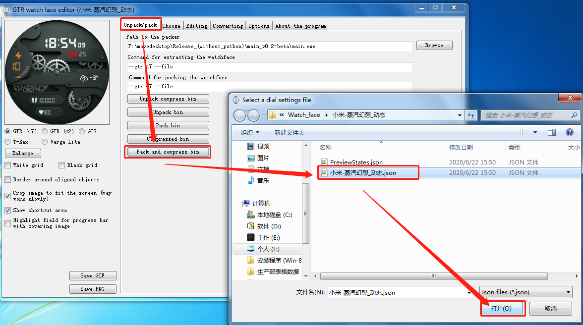

Rafi87
Posts: 53
Location: Slovakia
Post by Rafi87 »
kyle wrote: 26 Jul 2020, 01:07
Rafi87 wrote: 25 Jul 2020, 18:42
Hi
In the pop-up window, select the json file you want to pack, and then pack it
JSON file how to pack in BIN file?
kyle
Posts: 23
Joined: 22 Apr 2018, 14:32
Location: CHINA
Post by kyle »
Rafi87 wrote: 26 Jul 2020, 05:25
Hi
Just pack as shown in the figure
如有需要可联系!
Rafi87
Posts: 53
Location: Slovakia
Post by Rafi87 »
yes, I did
so, can i put that JSON file in my phone and set the dial?
don't need to convert to a BIN file?
kyle
Posts: 23
Location: CHINA
Post by kyle »
Rafi87 wrote: 26 Jul 2020, 06:40
yes, I did
Can only be converted into a bin file and flashed to the watch

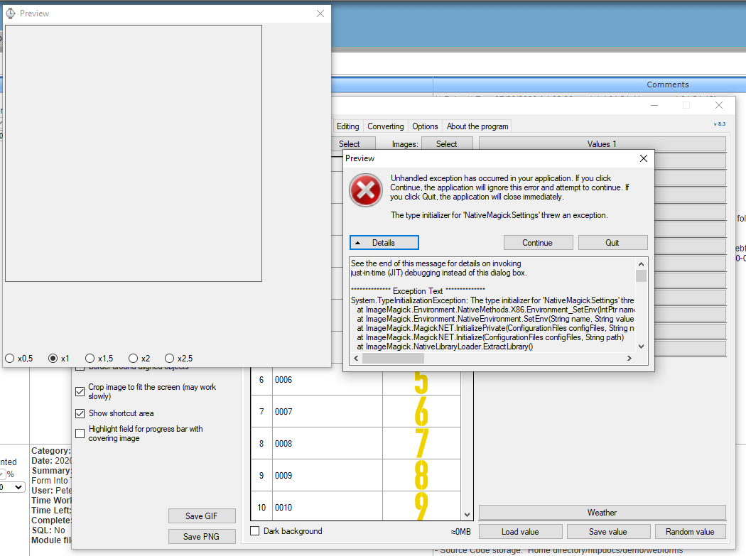

dinhlam91
Posts: 8
Joined: 11 Jul 2020, 15:48
Location: Ha Noi
Post by dinhlam91 »
Hello,
First, Thank you SashaCX75 for this tool.
I've the issue with this tool. I'm using it from version 8.1 up to date is 8.3. I can't preview and Edit the WF.
I'm using windows 10 Pro
Error:
See the end of this message for details on invoking
just-in-time (JIT) debugging instead of this dialog box.
************** Exception Text **************
System.TypeInitializationException: The type initializer for 'NativeMagickSettings' threw an exception. ---> System.TypeInitializationException: The type initializer for 'X86' threw an exception. ---> System.DllNotFoundException: Unable to load DLL 'Magick.Native-Q16-x86.dll': The specified module could not be found. (Exception from HRESULT: 0x8007007E)
   at ImageMagick.Environment.NativeMethods.X86.Environment_SetEnv(IntPtr name, IntPtr value)
   at ImageMagick.Environment.NativeEnvironment.SetEnv(String name, String value)
   at ImageMagick.MagickNET.InitializePrivate(ConfigurationFiles configFiles, String newPath)
   at ImageMagick.MagickNET.Initialize(ConfigurationFiles configFiles, String path)

Anyone can help me?

lawrence-dol
Posts: 4
Joined: 05 Nov 2019, 04:11
Location: USA
Post by lawrence-dol »
When working on a watch face, I frequently get an error in GIMP that some or another image cannot be saved and I have to close the WatchFace Editor in order to save. Can this be fixed by ensuring that images are always closed after being read, please?
Lawrence Dol

lawrence-dol
Give me your project and tell me which image and under what conditions it is impossible to edit. I'll see what the problem is and try to fix it.
lawrence-dol
Posts: 4
Location: USA
SashaCX75 : It happens randomly to all images in all projects from time to time. All I have to do is be editing some of the images used by the project and pretty soon GIMP will be unable to write one of them when I try to export it. I've had it happen often, probably because I am often editing and refining the images in GIMP and using the watch designer to see the end result as I tweak the image.
You can just open a project and just generate random values while using Process Hacker each time to search for file handles containing the folder name of your project; pretty soon you'll see assorted images held open. The exact files vary for each redisplay, and it seems to happen most commonly with images used for digits, though it's definitely not exclusively these.
It's easy enough to replicate in my workflow -- open, say, the 9 digits used for time display in GIMP, export each once to get through the initial prompts for exporting, then randomly generate display values in the watch designer and each time use CTRL-E to re-export each of the images. Before very long, one will fail to export. In Windows its describes a permission error, but that's normal for Windows when a file is in use. Exit the watch designer and you'll immediately be able to export that image.
