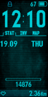

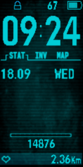

Try it on that PIPboy WF mentioned before. Images are already with less than 256 colors (in fact small numbers have only 2 colors). Pure RAW mode won't be generated because it's bigger than the limit, pure palette mode generates jagged images (it's not visible in the gif preview, you need to load the bin file in N&F or upload to the band to see it). Mixed palette mode creates nice WF with ~120kb file size.
Left mixed mode, right palette. Look at the numbers (battery, steps, distance), this is how it looks on the band.
Image Image
Maikeldevil
Posts: 64
Joined: 17 Aug 2019, 12:05
Location: unknown
Been thanked: 44 times
Post by Maikeldevil »
mysiak wrote: 03 Oct 2019, 07:36
Maikeldevil wrote: 03 Oct 2019, 07:11
Please give me a version that is unable to downsize, i'll fix it my way. It just needs some tricks that are hard to explain. You need to put all images in 1 pgn and run it in pngquant. (Drag file on .exe) then all images are reduced without quality loss with max 256 colors and you can separate them in 0001 0002 etc. PNGQUANT does not make the image ugly so its not the same as pallette mode!
Image Image
Ok, give me some time with this one, ll make all HD even the time numbers, np.
