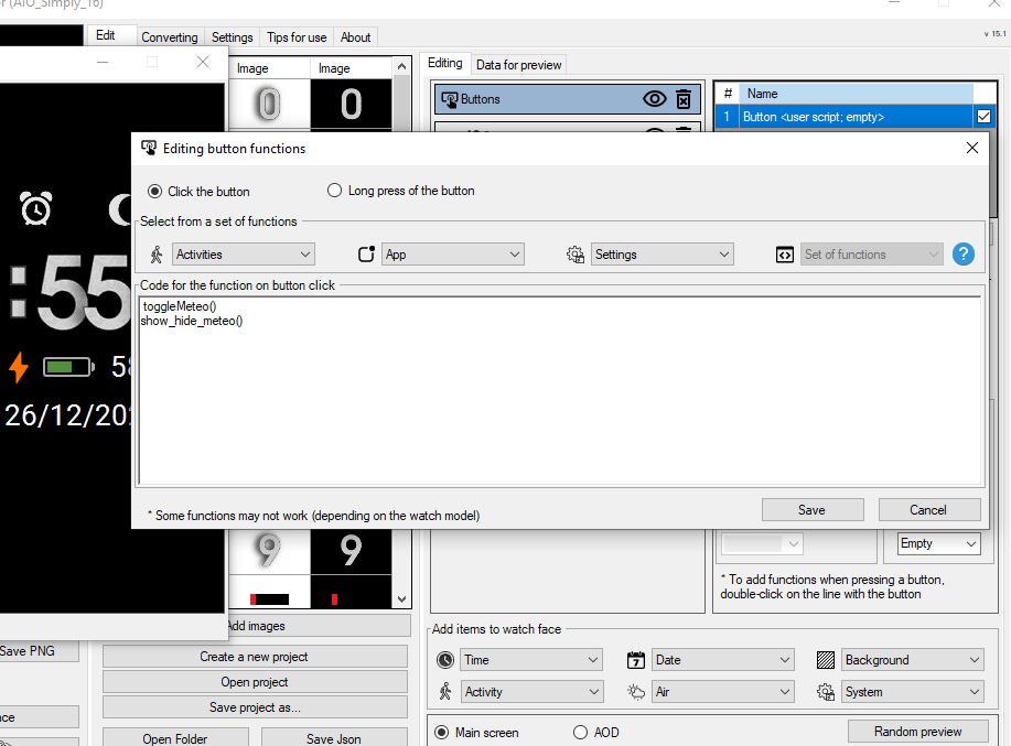

The script you created is in function form, so
when you place it inside a button, nothing happens. Since no functions are being called, you should put all the function scripts in the Scirpt section in the (User-defined...) section. ( user_function.js )
user_functions.js
Then, you can enable the functions via a button, just adding the functions you want to work.
toggleMeteo()
show_hide_meteo()
Button
Image[/url]

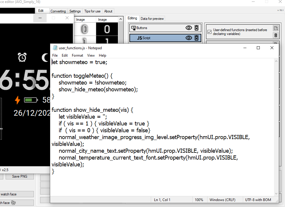

I tested your function and it didn't seem quite right. I fixed it as follows:
let showmeteo = true;
function toggleMeteo() {
showmeteo = !showmeteo;
show_hide_meteo(showmeteo);
function show_hide_meteo(vis) {
let visibleValue = '';
if ( vis == 1 ) { visibleValue = true }
if ( vis == 0 ) { visibleValue = false}
normal_weather_image_progress_img_level.setProperty(hmUI.prop.VISIBLE, visibleValue);
normal_city_name_text.setProperty(hmUI.prop.VISIBLE, visibleValue);
normal_temperature_current_text_font.setProperty(hmUI.prop.VISIBLE, visibleValue);
Or this
function show_hide_meteo() {
    let visibleValue = showmeteo;
Or this
Button add only
toggleMeteo()

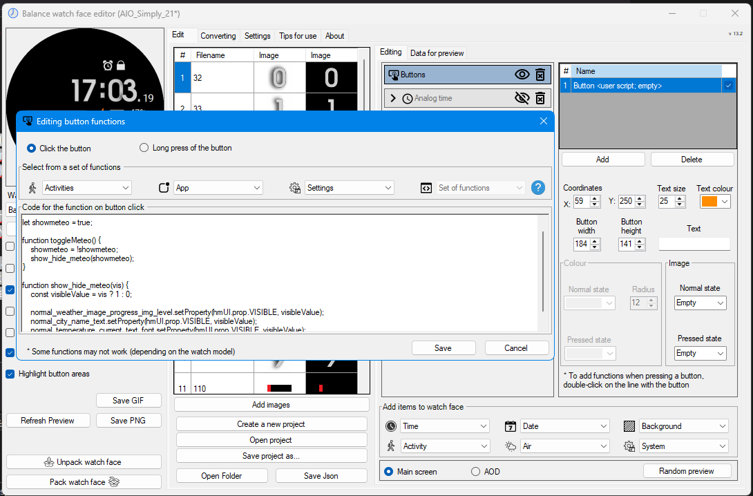

I've attached a sample project. You can open it and test it with an editor.
This file isn't a watchface, it's just a project file.
AIO_Simply_16.rar
(404.45 KiB) Downloaded 54 times
Preview for Tested
I recommend understanding the structure before proceeding.
Otherwise, you might get confused.
