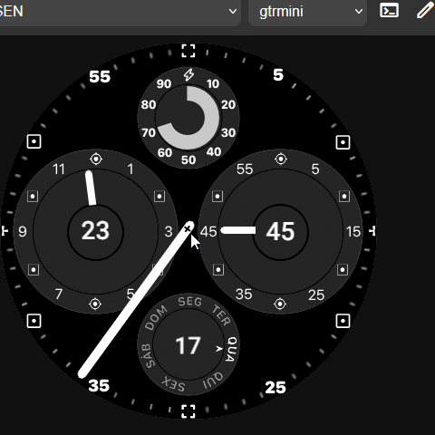

If you want your project reviewed,lobianco wrote: 21 Sep 2025, 18:57Hi, @asoo
Thank you very much for the quick response.
I made the suggested changes to the index.js file, then compressed it with a zip file.
The problem remains the same. I noticed that in my index, the scale_call() function is inside: if (screenType != hmSetting.screen_type.AOD) { ...
If you don't mind, could you review the attached index.js file?
Excuse my question, thank you very much in advance.
i recommend submitting your entire project.
If you only want to verify the validity of a script,
you can send only index.js . But you want to check the entire project, I think you should be attach all file about your project. The problem might not be with the script, but rather with other components, including the display order.
The index.js script you provided is correct.
However, there might be a display issue. When you click the color-changing button, the progress bar might not change. If you want the change to be immediate when the button is pressed, you can do this in two ways:

}From the index.js you provided, I made the changes I mentioned earlier and briefly tested it on zeppPlayer, as shown in the image. Some widgets may be missing in the sample image due to the lack of resources and limitations in zeppPlayer's simulation.

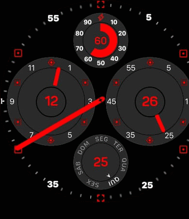

@lobiancolobianco wrote: 22 Sep 2025, 11:35@asoo
Here is the whole project, I just didn't put it up before because I didn't know I could.
I have moved your post to a new topic in the relevant forum for easier searching and to avoid confusion with the original topic.
I don't have a gtr mini, so all testing was done on zeppPlayer only. This is the watch face I modified.
You can see the fixes in index.js.
The main issue causing the watch face to malfunction
is the use of "object literals" for setting values.
I'm not sure why it doesn't work when I use the values from the "object literal" in the widget. However, I need to set the value of the object literal in the variable and use that variable in the widget for it to work properly.
Since I was also wondering why I couldn't use the object literal directly in the widget,
Your "Object literal"
const colors = {
1: 0xFFC9C9C9,
2: 0xFFFFCC00,
3: 0xFF479135,
4: 0xFFFFB3BA,
5: 0xFF5D6DD1,
6: 0xFFFF9224,
7: 0xFFFF0000
colorss = colors[colornumber_main]However, I'm not sure of this answer because I haven't found any official documentation.
@asoo
Thank you, it worked perfectly as expected.

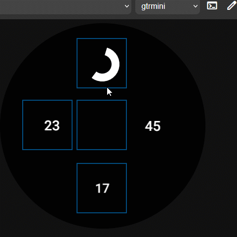

Hi, @asoo
In the example above, the battery cycle is changing color, as you taught me, but I've run into another problem: changing the color of the battery text element. I've tried everything, but I can't. I looked for a watchface that changes the color of the battery value, but I couldn't find it. Could you help me, if possible?
Thank you very much in advance.
normal_battery_circle_scale.setProperty(hmUI.prop.MORE, {
color: colorss,
radius: 27,
line_width: 16
normal_battery_current_text_font.setProperty(hmUI.prop.COLOR, colorss);

normal battery current text_font - does not work
normal_day_text_font - works

// Atualiza ponteiros and funds
normal_analog_clock_pro_hour_pointer_img.setProperty(hmUI.prop.SRC, `pontHor${colornumber_main+1}.png`);
normal_analog_clock_pro_minute_pointer_img.setProperty(hmUI.prop.SRC, `pontMin${colornumber_main+1}.png`);
normal_analog_clock_pro_second_pointer_img.setProperty(hmUI.prop.SRC, `pontSec${colornumber_main+1}.png`);
normal_background_bg_img.setProperty(hmUI.prop.SRC, `Back${colornumber_main+1}.png`);
// aplica a cor ao círculo a bateria
color: colorss,
radius: 27,
line_width: 16
// normal_battery_current_text_font.setProperty(hmUI.prop.COLOR, colorss); // not work in this case
// use this to change color
normal_battery_current_text_font.setProperty(hmUI.prop.MORE, {
x: 192,
y: 74,
w: 32,
h: 25,
text_size: 20,
char_space: 0,
font: 'fonts/Panton-Bold.ttf',
color: colorss ,
line_space: 0,
align_v: hmUI.align.TOP,
text_style: hmUI.text_style.ELLIPSIS,
align_h: hmUI.align.CENTER_H,
type: hmUI.data_type.BATTERY,
normal_day_text_font.setProperty(hmUI.prop.COLOR, colorss);
normal_time_hour_text_font.setProperty(hmUI.prop.COLOR, colorss);
normal_time_minute_text_font.setProperty(hmUI.prop.COLOR, colorss);
// end user_functions.js
The battery color changes normally.
I've attached the edited file. For GTRMiNi : You can see edited in index.js.
