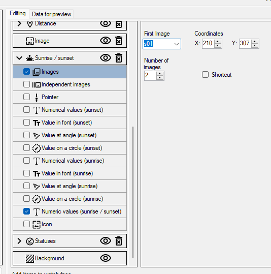

I wanted to make sunrise sunset icons changing according to "numeric values (sunrise / sunset) in watchface editor, but I don't understand how these icons are supposed to work.
I used images element in sunrise/sunset and put two images, first one for sunrise, second one for sunset.
But when applying watchface on watch icon is always for sunset, even when value is showing sunrise

Sorry, watch model is GTR3.
I tried putting one on background as permanent one but it works really weird, currently its showing sunset icon and 06:56 value which indicates sunrise, not the sunset.
I also tried puting 2 images but still acts very weird

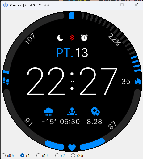

What I want achieve is that whenever value is at morning, for e.g. 6:45 to show icon which indicates sunrise, (one with arrow pointing up) and when value under icon shows e.g. 16:10 which indicates sunset to show icon for sunset (one with arrow pointing down)
here is preview of watchface, you might understand it better
