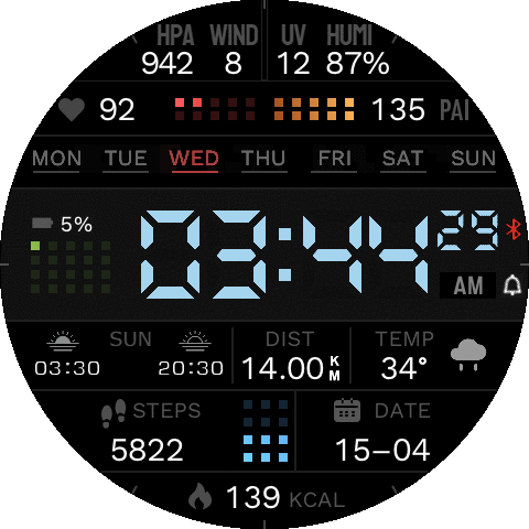

Hello to all. I modified this particular watchface which is an official watchface from zepp store to my liking and wax has made it public some time ago. After modifications the number font used in all elements except the time font and the weekday font it is not clear and clean as seen in the wax preview watchface. They looks faded. I have noticed in various watchfaces that I have converted with Sasha's editor that after the conversion some elements lose their clarity and purity such as numbers and fonts. What I want to ask is if someone can fix the fonts I said like the numbers of elements except time numbers fonts and the fonts of the days of the week and be able to replace them myself or if there is some other way to fix the png files of numbers and fonts is welcome. Thank you. A big thanks to wax for his work.

It is normal that when the watchface is unpacked the quality of the image will degrade. Because in the process of packing the images are encoded in the ZeppOS format, the quality of the images will decrease and when unpacking again, the quality of the images will decrease further.
If you repeat this process many times, the quality of the image will continue to degrade (your unpacking, if I think correctly, your image after unpack should be 3nd from the original image so the image quality is gone.) This problem is not caused by the Sasha's editor . But it is caused by the process of packing images according to zeppOS standards.
There are 2-3 possible solutions.
1. of the PNG image from the creator
2. Create a new image with TTF
3. Modifies color the image with Graphic editing program.
This is an example of correction number 3. This file is not a dial in this RAR is includes images that have been modified and the watchface that packed.

A little bit of clarification.
When packing a watch face, the images lose colours, but the clarity of the image does not change. This can be avoided if you enable the option to pack without loss of quality. But nobody switches it on because then the process of packing takes longer and the size of the watch face becomes bigger.
And if you convert the watch face between different models, then the clarity of the images will be lost.

Thank you, Sasha for info. Where is that option to enable to pack without loss of quality?SashaCX75 wrote: 03 Apr 2024, 19:09A little bit of clarification.

Finally i find the option to pack without loss of quality. Thank you, Sasha for this amazing tool.
