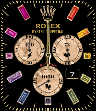

Was wondering if anyone could make this watchface. It's the multicolour watchface, but I would just like the rings, the nike logo and the DAY all to be red.
https://amazfitwatchfaces.com/gts/view/6857
If not possible, no problem!

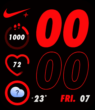

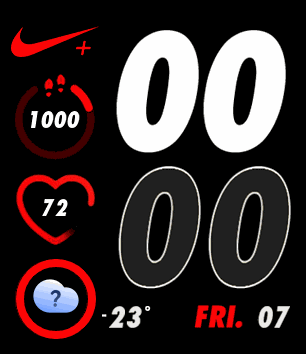

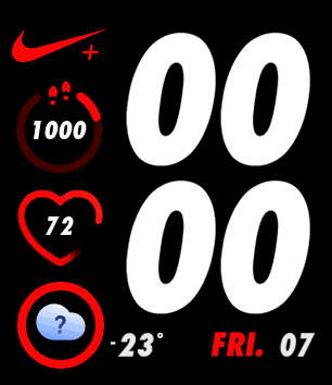

I don't have GTS2mini
That I fulfilled this request. In order to find tools for those who are interested in making their own Gts2mini watch faces. From testing all the tools that have been posted, one can definitely create a watch face. So I probably won't be accepting requests for this GTS2mini again.
therefore learned to know
Image Image
- Not test on real device only test by Editor on web
Watchface :
RED_GTS2mini.bin
(1.18 MiB) Downloaded 200 times
gray_white_Gts2mini.bin
(1.18 MiB) Downloaded 203 times
white_Gts2mini_packed.bin
(1.18 MiB) Downloaded 185 times

This almost perfect but I would like the time to be white!
How in the hell do you do these request so fast?? 🤣😁😁
Posts: 2208
Has thanked: 425 times
Been thanked: 2131 times
Kurtyyyyyy
Download link :
viewtopic.php?p=12537#p12537
And please read carefully before download
If you want to edit on modify this ported watchface , please try it yourself. from the tools previously posted.
