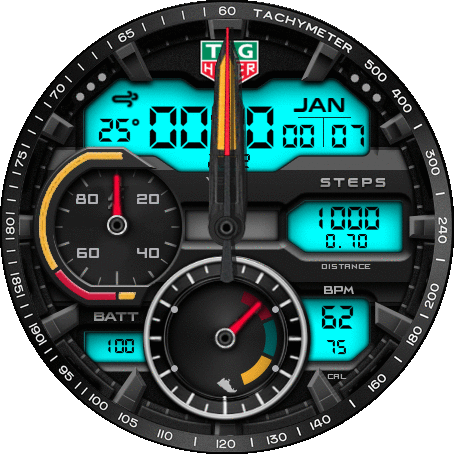

Hi, is there a way to convert a 47mm watchface to the T-Rex 2 with your program? It is this watchface I am talking about:
