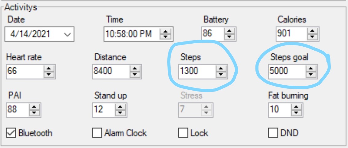

JPinTX
Posts: 4
Joined: 19 Jun 2020, 01:20
Location: Houston
Post by JPinTX »
@SashaCX75 I'm not having an issue with absolute STEPS (the specific number of steps I've walked today)... the issue I'm having is displaying % of STEPS GOAL using a Pointer (i.e. I want to have a dial with a pointer that shows from 0% to 100% of Steps Goal, not the number of Steps... If my Steps Goal is 5000 steps, and I've walked 1300 steps,
the pointer should point to 26%, if I've walked 4500 steps, the pointer should point to 90%). I'm setting this up under ACTIVITY tab, ACTIVITY GOAL subtab, POINTER.
When I change the test values in the tool, it shows correctly on both the Main screen
and AOD screen.
However, when I sync watchface to watch, the Pointer is correct on Main screen,
but incorrect on AOD screen (it always points to 50% no matter how many steps I've taken).
I've simplified my watchface for testing in case there is a memory/size issue, but it still has a problem on the AOD screen. FYI, the dial on the left shows the Battery %, and is correct on both the Main and AOD screens.
Thanks for the help!

JPinTX
Indeed, the ACTIVITY GOAL option on the AOD screen does not work. This is a firmware error.
In your case, I advise you to use the STEPS parameter, the pointer will show the progress towards the goal of the steps.

Post by JPinTX »
SashaCX75 That works! Thanks so much for the quick reply and again for a great tool. I see more options in v2 of the tool and just have to try them out. I thought I had figured out most of the ACTIVITY GOAL subtab, but couldn't understand why the Pointer didn't work only on the AOD screen.
