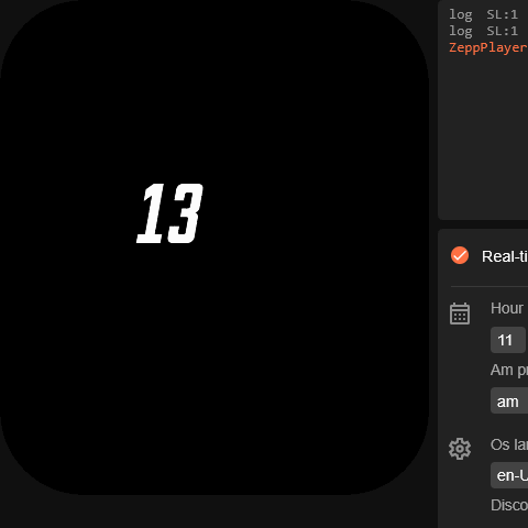

The code you attached seems to work, but I have a few observations:
1. I don't see the `normal_digital_clock_img_time` widget in your code, so I can't verify that part.
2. `let timer = timer.......`
Declaring a variable like this might cause errors with the `timer = timer.....` value due to potential duplication. I recommend changing it to a different name, such as `timersecond = time......`.
Or, if you don't want to reuse the variable, simply call
timer.createTimer(0, 1000, updateSeconds);
directly without using `let` the variable.
I've attached a modified and tested example on zeppPlayer.
Next time you ask a similar question, please attach the entire project.
This is project file ( it is not watchface )
compress by use Winrar 7.20 https://www.rarlab.com/download.htm
testSecond.rar
(154.92 KiB) Downloaded 67 times

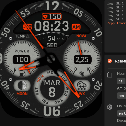

I'm not sure if you've resolved the issue yet, but based on my inspection of the files this morning, I found that the problem wasn't displaying correctly in Bip6 because:
- There was redundant use of variables in user_functions.js and user_script_end.js.
- The widget and variable values ​​were declared redundantly in user_script_end.js.
- There was an incorrect layering; user_script.js should be used, and the "JS script" widget should be moved below the "image".
Preview and project
This is not watchface , it is the project I modified, based on my understanding of your script.
add function switchTime() in user_functions.js
NovaMK1-Bip6.rar
(1.05 MiB) Downloaded 75 times
You can see the result in this preview.
