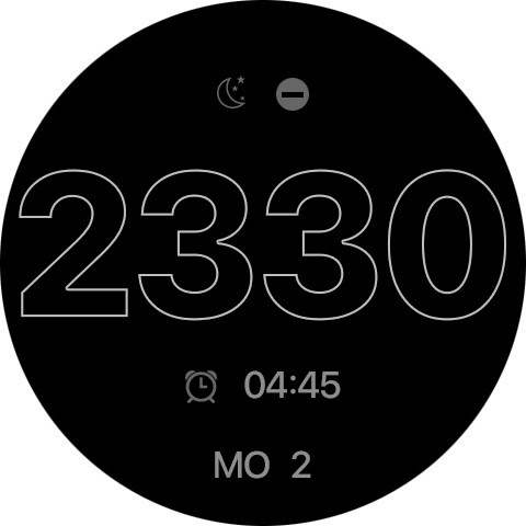

Your problem won't be in the display, but in the background applications running on your watch.
Of course there's a difference in what the always-on display contains compared to the fully active view, and I'll give you a tip - find someone who has Garmin watches and look at the night display of information and I think you'll understand where the problem lies. The white display is only 40% on a black background #000000. White will only show information about sleep, time, alarm settings, and day display, nothing more.

You're welcome, and yes, that's the case even when AOD is active, everything continues running in the background. This means step counting, recovery, sleep tracking, etc. Most importantly, the watch constantly verifies if the phone is available and checks for new information. So even though it looks like we have a power-saving mode, the watch is actually running at 80% in the background.

As I showed in the picture above, simple readable information on the alarm clock - alarm time/no alarm, do not disturb, sleep and info about the day and time, nothing more.
