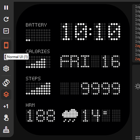

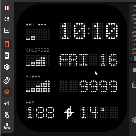

I'm not sure about the script you mentioned., but judging from your script, it seems quite confusing. I'm not sure what some of the functions you created were for, however I haven't investigated them. However, I've created an example from your watch face you posted earlier, I removing some function that I think it unnecessary elements by using // and /* */ to prevent that script from running.
As far as I've tested, it can change the elements in the AOD.
There's a slight issue: when you reset the clock, the home screen returns to the first color, but the AOD remains the last color you selected. This shouldn't be a problem, as when you choose a new color, the AOD changes to reflect the home screen, so I haven't done anything further with this part.
As I mentioned, I don't make watch faces whose AOD changes elements based on the home screen, so I'm only working on what I understand.
Dotted-Clock_Switch_ON_AOD.zip
(534.92 KiB) Downloaded 75 times
V.3 Fixed and added widgets in the AOD section to make it display as complete as possible.
Dotted-Clock_v3.zip
(574.43 KiB) Downloaded 84 times
In AOD, at certain times, the screen will move by about 1-2 pixels to maintain the screen. This causes some widgets to display out of sync.
This can cause the background to move from a specified point, resulting in the overall image having errors such as the text frame having the background color displayed.(this cannot be changed due to system requirements). If you want to fix this, you'll have to completely redesign the display, which I won't do, so I'm letting you know here.
I don't really interrest about this part. I personally don't use AOD, so I won't make any further changes. If you need to do anything further, please try to find by yourself.
