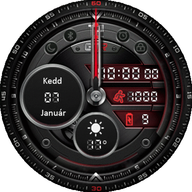

I took my heart rate
I deleted the battery indicator on the graphic and changed it instead of the heart rate to show in numbers
the date remained and I added the months and the name of the days
that is all
I am attaching a zip file
please create it for me
I have a 42mm version
that is all

I found one error, the battery shows only one number, I have a 45% battery and it only shows the number 4
I already fixed it and redesigned the design a bit more
thanks again for the help
