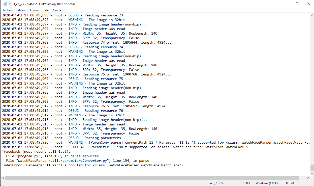

I'm using the 8.1 version of your tool with this one https://amazfitwatchfaces.com/gtr/view/6815
i'm getting an error....could you help me ? I was unable to find 8.2 version, is not at google drive and i can not log into 4pda.ru
Thank you in advance.

[mention]kampanita[/mention]
Checked this dial. I normally unpacked it. Try resetting the program or downloading the latest version.

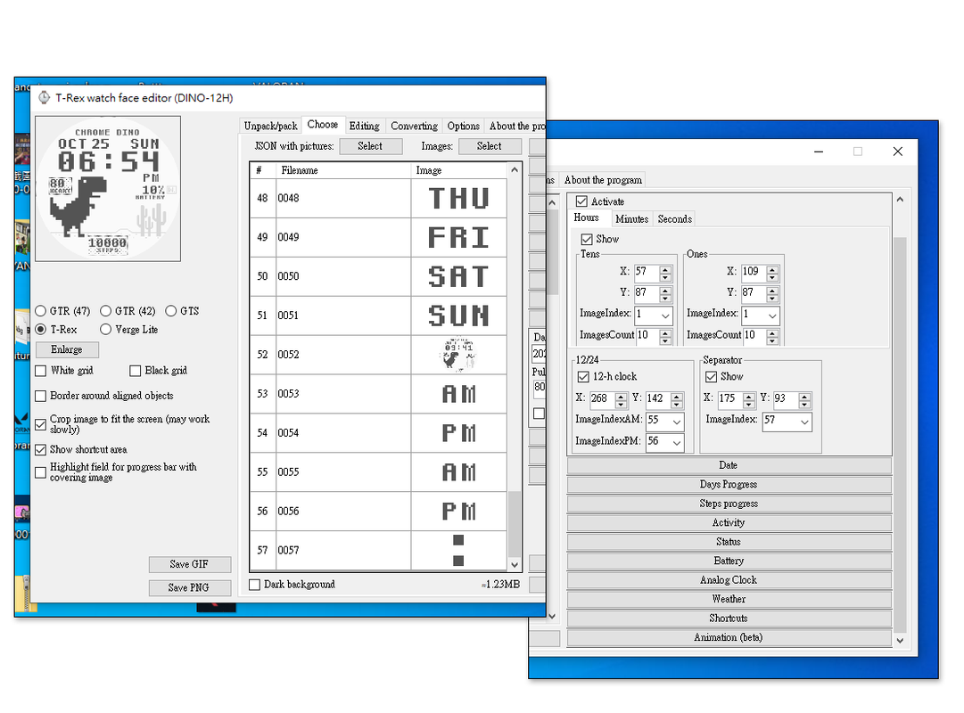

I try many watchface for T-rex
they all dont show AM/PM on my watch , it's no photo or incorrect
can someone try this?
another question~
can I show the two digit year?
thanks!~

[mention]wing0826[/mention]
The format for displaying the time on the watch depends on the settings of the phone. For the 12 h format to work. must be enabled in phone settings. (Settings-System-Date and Time-Disable 24-hour format.)

after trying, i got this
if I want use the AM/PM image, I must set the two AM & two PM image,
like this one, but I dont know why :shock:
https://amazfitwatchfaces.com/t-rex/view/908
Messaggi: 823
Località: Ukraine
Been thanked: 1036 times
Messaggio da SashaCX75 »
Not. One AM image and one PM image are enough. The dials seem to support two images for AM / PM (like for two languages), but this is not implemented in the program.
wing0826
Messaggi: 35
Iscritto il: 09 giu 2020, 14:47
Località: TW
Has thanked: 9 times
Been thanked: 4 times
Messaggio da wing0826 »
Oh okay, now I get it!
thanks @SashaCX75 making this program!~
