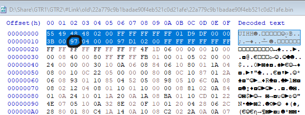

The maximum number you can upload . I am not sure.
But the problem that the new .BiN overwrites the last BIN is caused by
The entire header of the file has the same value, making the clock see as the same file, thus overwriting.
If you want to add a custom BIN without overlaying the existing one. You need to edit the header file to be different from the existing one.
You can edit 1 byte in the header of the file. Then can take that file to use.
How to do :
You open the BIN file you want to edit with HEX edit and (overwrite) the 19th Byte to a value that is unique to the existing one on your watch. Files modified upon installation will be saved without overwriting the existing files.
Please edit by Overwrit the 19th Byte , Do not edit by insert if you edit by insert the BIN size is change and BIN will be broken
Imagem
But this kind of correction may have some risks because I'm not sure What is the system used in the header? But as I understand it, I think the program Probably used to verify files
If you are unsure or do not dare to try it, I recommend waiting for the program developer.
Editing files to import the clock is risky. Please use your judgment before deciding to give it a try.
Ps. : Personally, I have tested and applied it. Haven't had any problem yet. I added 4 files I like on the watch. it's work normal.

Hi asoo,
Thanks a lot for your detailed answer. I just used the HxD application and randomly changed the 19th byte, and was able to add a new watch face without overwriting the previously installed .BIN file.
Thanks again :-)

Great tip. I congratulate you on your knowledge and idea. It worked flawlessly for me. COOL !

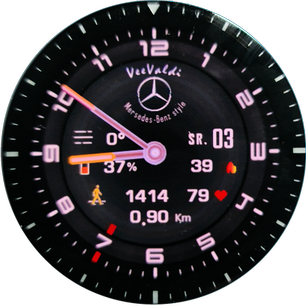

At the link: https://amazfitwatchfaces.com/gtr/view/12120 I have placed a new (version 3) of my watch face called "VeeValdi Mercedes", intended for the GTR 2 watch.
In this next version of my watch face, I have introduced or improved the display of additional information. Currently, the watch face displays km, steps, battery status (in percent and with a changing icon), heart rate, kilocalories (kcal), weather (in the form of an alternating icon and a number showing the temperature in ° C), two-letter abbreviation names of the weekday (PL), the day of the month (number), as well as the icon of no bluetooth range and the alarm icon (alarm clock, if an alarm is set).
Below I present a picture (taken from a photo) of the changed watch face. After uploading to the smartwatch, it looks much better.
A shield created thanks to the advice of people from this online community. Thanks a lot.

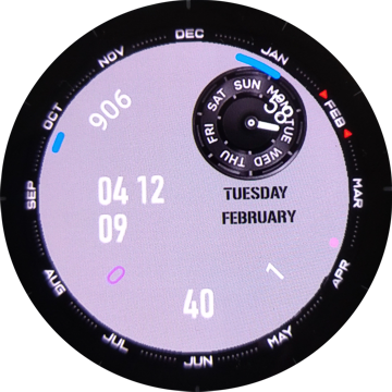

bigdigital /py_amazfit_tools have new update (07-02-2021)
- Add in type. Replace types in FontRotate
- Fixes in header. Use CRC16 to generate unique dial ID.
- header_1.md (Initial release )
- Can unpack watchface have "week Progress"
https://github.com/bigdigital/py_amazfi ... /tree/GTR2
Imagem
My tested unpack and pack , it's Work .
Thank bigdigital.kov very much for new update
