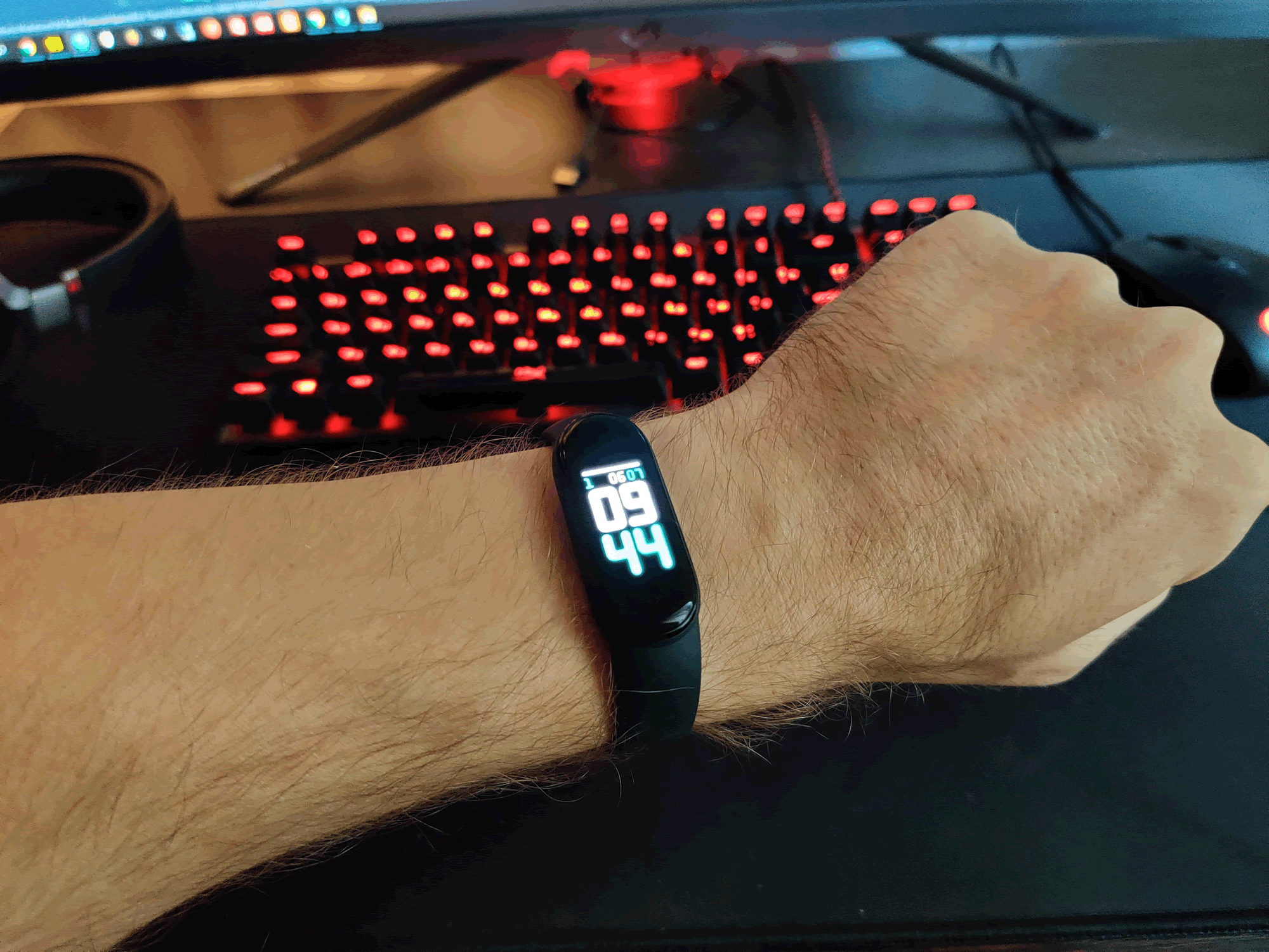

Well.., my first Band 5 WF complete and works well! ;)
Here is the all bundle:
Waiting for an upload category...
