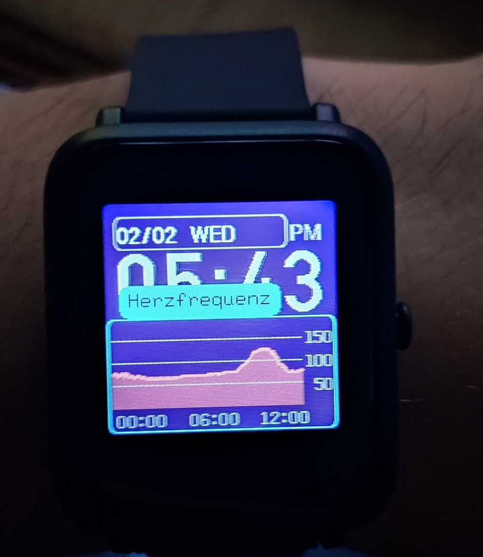

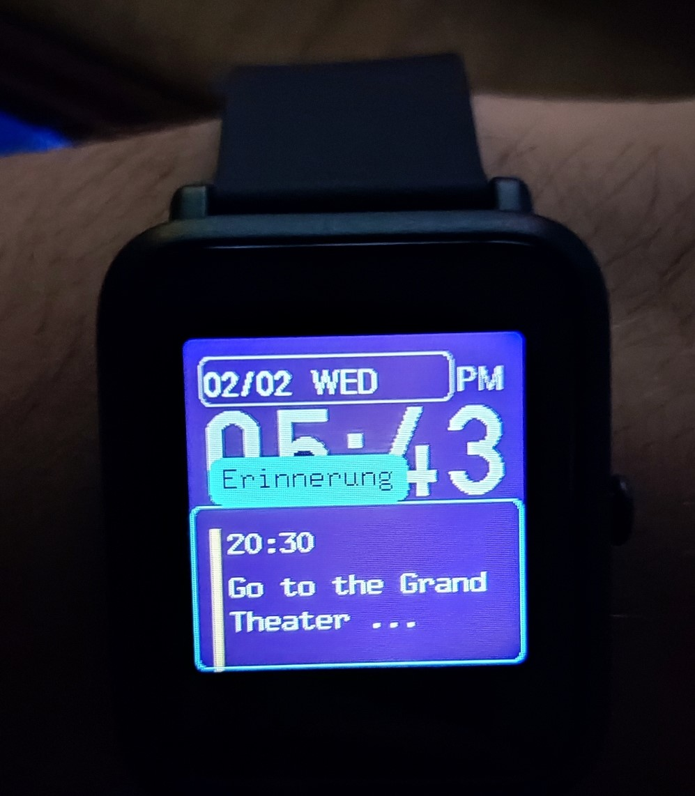

Hello Everyone,
is there a way, to display a graph of the Puls, like the preinstalled from amazfit bip s (one of the two customizable?
And ist there a way to display a Calender reminder, also like the preinstalled from amazfit bip s?
Calender reminder
Calender reminder
Pulse Graph
Pulse Graph
Thank you for any infos
Flo
