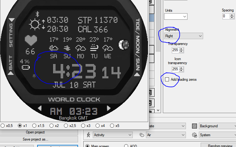

-- 2.1 To create a DigitalHour display where hour digit is shown in H:MM format:
There are actually several ways to do this, but the easiest way is to set it to display without leading zeros in the time widget. However, I'm not sure your editor has a this function or not . If not, you'll have to edit the script yourself. I'm also unsure what format your index.js is in, whether it's encrypted or not. An encrypted index.js file after packaging might be difficult to modify. Or, the easiest way is to try searching... An editor capable of performing this function for example, "Watch face editor for Amazfit watch on ZeppOS" by SashaCX75 for Windows.
Example
