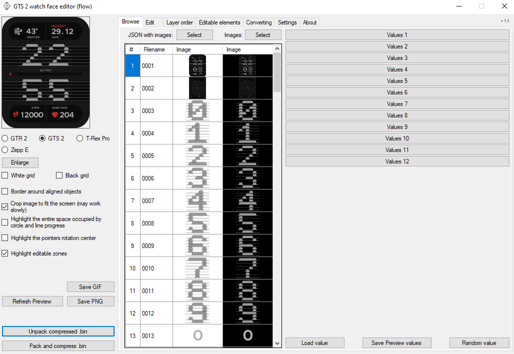

If you want an easier unpack, try sasha's Editor made for GTR2 GTS2 .....
viewtopic.php?p=8392#p8392

I actually did try to use it but I wasn't able to unpack it.

I'm not sure that your issue , I've tried it, the program can unpack the files you mentioned without any problems.

That's so weird. Maybe I'm missing some dependencies? When I tried using the py amazfit tool with the GTR2 unpacker, I had to download JRE 1.8.0 for it to work.asoo wrote: 21 Nov 2025, 09:56I'm not sure that your issue , I've tried it, the program can unpack the files you mentioned without any problems.
