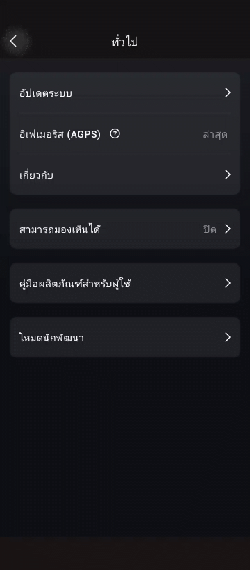

I also use Zepp V9.15.2 and was able to install the watchface on my Bip 6 via QR code without any problems.
I expect that if you follow the steps correctly, it should install successfully.

Fearless-Week ha scritto: 07 gen 2026, 14:36
thanks asoo for your replying and Im sorry to bother you but... I did exactly what that link you posted since yesterday.
I think twice before making any post on any forum, if I cant find a way to do it by myself, I ask.
This is what I got
The problem you attached the image for can only be guessed to be caused by several things:
1. If you created the QR code yourself, it's possible that:
You created the zpk file incorrectly.
2. The server where you hosted the file is experiencing problems or does not support direct downloads.
If you used a QR code on this website, the problem may be due to:
1. The QR code has expired.
QR codes created on this website have a limited lifespan; you cannot save them for permanent use.
If it expires, you need to create a new one by refresh that page.
That's all I can answer for now. I will not answer this question further in this thread as it will confuse the main topic.
As I said before, your question should not be in this topic.
I have already provided a link to the correct topic. Please ask your question in that topic.
viewtopic.php?t=3873
P.S. The entire problem analysis is based on the assumption that you need to understand the process of correctly creating a zpk file and understand how to host files on a server.
And in case you host files on this website, you must understand that the resulting QR code is not permanent.
Fearless-Week
Messaggi: 12
Iscritto il: 27 mar 2020, 13:35
Località: Amsterdam
Messaggio da Fearless-Week »
No, that wasnt the problem at all, it wasnt an expired QR and it wasnt a zpk that I never created. Even more, I dont have any idea how to upload a zpk file to this device.
As I suspected its because of the version. So, this is what I did (to everyone who has the same problem as me): "Parse mini program package failed"
I downgraded to Zepp v9.8.2.
How did I did that?. I downloaded the apkm, de-compiled and then recompiled again. Uninstalled the previous version v9.15.2 and then I now can upload every skin from this device without any problems using any QR.
Messaggi: 2200
Località: ͼͽ Thailand ͼͽ
Been thanked: 2121 times
Messaggio da asoo »
Fearless-Week ha scritto: 07 gen 2026, 20:18
Congratulations on resolving the issue.
However, I'm still surprised because I'm also using Zepp Version 9.15.2 and was able to install it via QR code on Bip6 and Balance without any problems.
