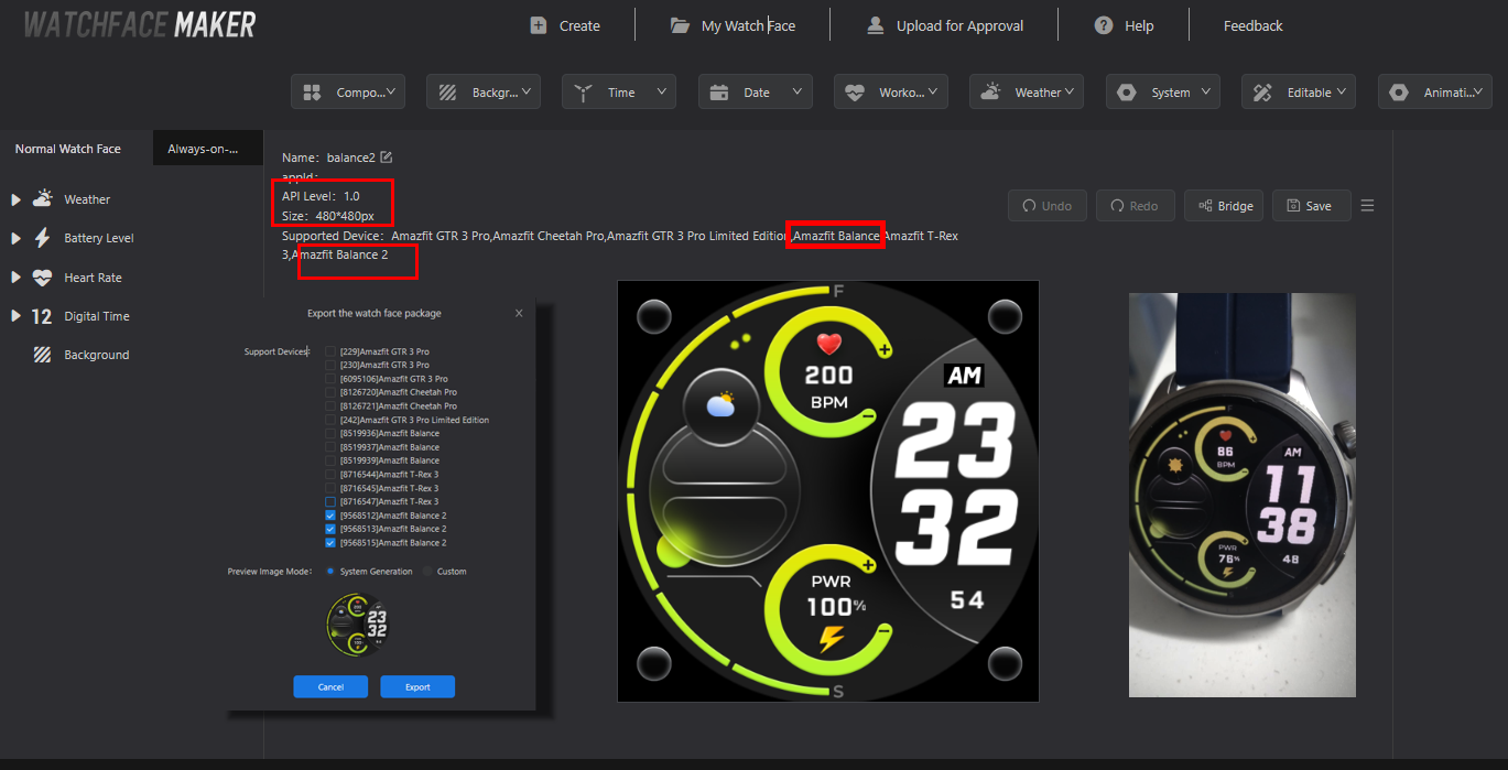

🖼️ Picture
From testing by creating a watchface with the official tools, it can be seen that Balance and Balance2 are in the same category.
I have tried creating a watchface and exporting it to Balance2 model and trying to install it in my Balance. It works. Personally, I think that the image management of Balance2 should be the same as Balance, so I expect that Balance watchface can be used on Balance2 as well.
However, if there are new API capabilities added in Balance2, it is possible that it will not be done properly in Balance.
But I have not seen that in the official editor, which still uses API 1 to manage. So, in conclusion, if a watchface created by the official tools, If I understand correctly, it can be used with Balance2 and Balance.
Hope the information is useful.
Best regards.

asoo escribió: 23 May 2025, 06:49
Best regards.
Thank you very much for the detailed information and for taking the time to test it out — it’s really helpful and appreciated.
Given what you’ve found, do you think it makes sense to create a separate filter (in existing category) for the new Balance2 model at this point? Or would it be better to keep things as they are for now, since compatibility appears to be the same?

GIK-Team escribió: 23 May 2025, 07:46
I'm not sure either since I haven't seen an official Balance2 dial yet, but overall I think it can fits into the same category as the Balance watchface. However, if it is subdivided in subset on Balance area, it will look more organized.

Mensaje por SashaCX75 »
Watch faces from Balance work on Balance2. However, not all watch faces from Balance2 work correctly on Balance. There are problems with the encoding of some images, and new features do not work.
