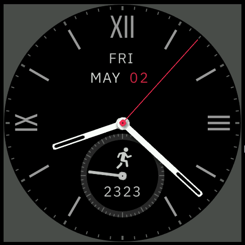

Could someone please modify the Elegant watchface for the Amazfit Active 2 to display steps at the bottom? In the stock version, it's only possible to show sleep hours and PAI

gabbre wrote: 01 May 2025, 06:54
The dial as you mentioned in the script section is encrypted, so it cannot be edited. However, I have recreated new by use origial image, but the editor I use does not have the "sleep" and "Readiness" display management.
So I created it using user_function and user_script that the editor supports in this section.
And I change switch the data in the circle, I have changed it to use click on the icon to switch the data, and the shortcut can be opened by clicking on the "Number" of those data.
In AOD mode info in the Circle will show only "Steps"
In readiness part, tested on simulator can show pointer progress, but tested on "Bip6" and "Balance" it can't show.
I'm not sure what effect it will have on Active 2, because I don't have Activer2 to test with.

Thank you very much both for the watchface and for the detailed explanation. I would have been satisfied even with just the steps section, without the others.
I can confirm that the readiness screen also works on the Active 2
I had tried to recreate the watchface using the assets with Watch_Face_Editor, but I couldn't manage to align the hands properly. It's all quite new to me; I'm trying to learn through trial and error without asking too much from others, but sometimes I just can't find the solution
