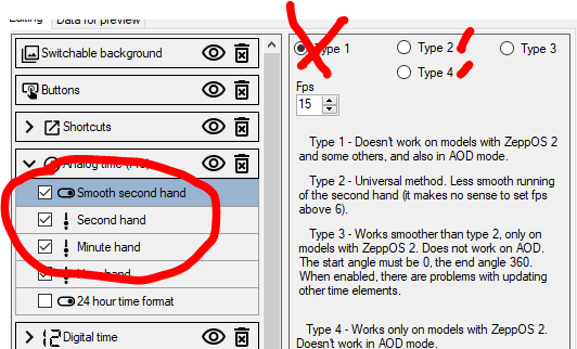

Next time, if you have any problems creating the Amazfit active watch 2 face, you should post in the Amazfit active area, because this area is for Watchfaces tools.
viewforum.php?f=178
And I recommend that you attach the problematic face file so that those who want to help can check the problem correctly.
From the information you provided, I can only guess as follows:
1. You use "Watch face editor for Amazfit watch on ZeppOS by SashaCX75" to create the face.
2. You use Analog time pro and use smooth second to display the hands.
If you do, check around to see what type you are using to display.
I guess that you are using "type 1" to do it yes or no.
If so, change it to "type 2" or "type 4", and your Analog hands can work normally, because type 1 is only available on ZeppOS 1.
However, this is just a guess based on the information you have provided. If it is not correct, you will need to send the file of the dial you are having problems with so that I can check.Otherwise, this is all I can do.
