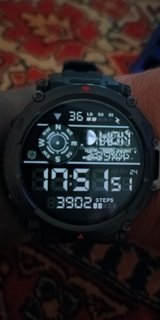

asoo, thank you very much for this fantastic watch face, it's amazing. I have a purely technical question: is there any way to prevent it from using a lot of energy, because such information is displayed on the display of my watch? Maybe you can slow down the dot seconds between the hours and minutes, because it works very quickly, or simply turn it off so that the dots are displayed all the time without them working, because digital seconds do work. Or maybe the working compass has an impact on higher energy consumption and there is a chance to turn it off, because after clicking the triangle, the normal compass turns on.

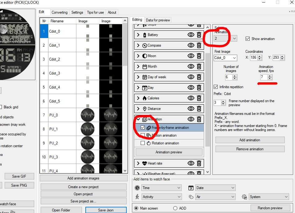

The message indicating that the power consumption is higher than normal will be displayed when the watch face has animation enabled regardless of the number of animations. Therefore, if the animation is used , the message will be displayed.Pyczek ha scritto: 11 ago 2024, 18:31Spoiler
Once again, I apologize for the confusion that resulted from my ignorance, my intention was not to mislead anyone. I will post requests regarding my trex ultra in the appropriate place. I thought there was no difference between trex 2, ultra or gtr3 and that converted chainrings worked the same on these models. Regards.
This watch face uses only 2 animations, so it will consume slightly more power than normal.
As for the speed of the animation, please manage it yourself. You can unpack the watch face and edit the "speed fps" value as you like. It is not difficult to do this because you do not have to create anything new. Just enter the values you want.
When you are done editing, just pack the watch face and you will have a watch face ready to use.
And I have already said that I will not edit the watch face I have finished.
Because I do not have that device. The minor requirements for speed, image placement, etc. are not difficult to do. Please do it yourself.
Minor adjustments in terms of speed and layout, please do it yourself, because each device has different limitations and I do not have all devices. I used a simulator to create it.
The speed displayed in the simulator looks normal, not too fast. But if the display on your device looks faster than you want, please modify and test until you are satisfied with it by yourself
Because I cannot know your satisfaction. And each device has a different display. So please do it yourself.
As for the compass, from what I've tested, I don't think it's a power hog, since there's no power consumption warning in the compass. I don't think this should be a problem, and more importantly, removing the compass would require a lot of script modifications, which I won't do, but if you want to modify it yourself, I have no problem with that.
This is my personal opinion. If you are serious about the power consumption of your watch, I recommend not using a watch that has element-changing features or uses "user script" to create the watch face, because it is inevitable that these watchface will consume more power than normal. and You can't avoid the higher power consumption of these dials.
I understand, it's probably the flashing dot seconds between the hours and minutes that consumes more energy. Maybe I can slow it down or turn it off myself. Please send a link to the program where I can try to do this. Thank you very much again for the amazing watch face.

@Pyczek
This is the best I can do in this case
I have limited the animation to be shown only once. When the animation ends, the animation stops, only showing a still image.
You can download it in the original thread.
