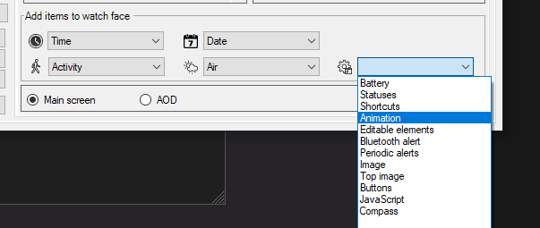

If you want to make " : " blink in Digital, you can do it in several ways.
But the way I recommend is to use "animation frame" to do it. By creating 6 images (because the animation will work correctly if there are more than 5 images)
I tried as you suggested, with 6 images (i also did it with 8 and 10), but something seems wrong, every time the animation starts makes some micro stop after blinking 2 times > micro pause > blink 2 times again, this happens with 6 images. With 10 images same behaviour but 4 times blink, then micro pause and resume, all over again.
