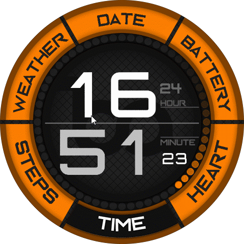

Hello, guys. Please can someone with skills from creators convert this watchface exactly as it is for GTR3 Pro because editor 11 can't convert it properly because uses ttf font and GTR3 Pro don't support ttf font. Thanks to creators for the help and thanks to Lattenknaller for his amazing works. Thank you.
https://amazfitwatchfaces.com/balance/view/1201

In my opinion The problem shouldn't be related to the editor. I think the program itself does the size conversion correctly. The problem should be that GTR3pro doesn't support TTF for some elements, so even though the program can convert the sizes correctly, It cannot be used with GTR3pro because the problem is that GTR3pro does not support TTF.
Therefore, in the case of wanting to use this dial with GTR3pro, you must create a new one by editing the custom script and creating an image font to use in place of the element that uses TTF for display.
This file is not watchface. This file contains images of numbers only.

Hello and thank you for reply. I know that it must be from created from scratch thats why i request for help from skilled creators. I don't have the knowledge and the skills to create watchface from scratch. I like very much watchfaces with changing panels like this.

Download GTR3pro , GTR3
This watch face may not function as original.
Because some commands cannot work on GTR3pro , GTR3 .
( ZeppOS1)
GTR3PRO:
BA-Simplify_imgFont_GTR_3_Pro.zip
(596.62 KiB) Downloaded 99 times
GTR3:
BA-Simplify_imgFont_GTR_3.zip
(630.87 KiB) Downloaded 98 times

I think GTR4 can be converted with an editor from the original file, so I think I won't do this part.
You can convert and edit the script a bit and it should work with GTR4.
After converted , script that needs editing, search in script ( user_functions.js )
and edit the x,y,w,h values ​​to match the code below, it can be used (there are 2 points)
 normal_background_bg.setProperty(hmUI.prop.MORE, {
 x: 0,
 y: 0,
 w: 466,
 h: 466,
 color: colorstring,
  normal_analog_clock_time_pointer_second.setProperty(hmUI.prop.MORE, {
 second_path: secstring,
 second_centerX: 233,
 second_centerY: 233,
 second_posX: 233,
 second_posY: 233,
Looking at the work you've uploaded, I think you can do it easily.
