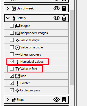

Thank you so much for convertion and for font extractor site. I didn't know there was such a site for fonts. If i create the fonts can I add them with the sasha's editor?
- Posts: 2211
- Has thanked: 430 times
- Been thanked: 2132 times
If the editor can open it, you can simply convert to your device type and change the TTF element to use "Numerical values" element and use the image file you created in the element you changed.amazfitfacesafrica wrote: 26 Jan 2024, 12:11Thank you so much for convertion and for font extractor site. I didn't know there was such a site for fonts.
