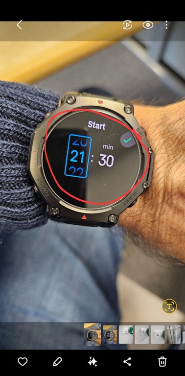

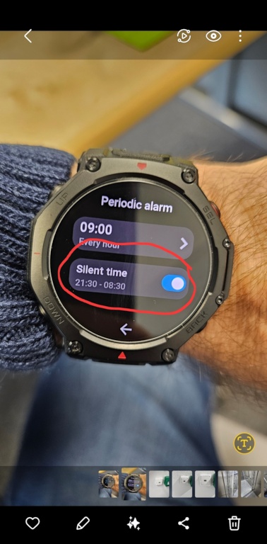

Hello, I need help. I have a T-REX 3 Pro, and after installing the app, I can't activate silent mode. When I try to set the silent mode hours, after setting the initial time and confirming it, the screen goes black for a moment, and I have to re-enter the silent mode settings, but the time remains unchanged, and this happens over and over again. I can't even set the end time for the feature. Please help. Regards.
- SashaCX75
- Posts: 823
- Joined: 26 Oct 2019, 15:18
- Location: Ukraine
- Has thanked: 13 times
- Been thanked: 1036 times
@Darek1969 Please send screenshots of each step so we can understand exactly which settings you are trying to access and at what stage the error occurs.
Good morning, I am sending photos of the problematic option. Please help because the application is very useful
I simply cannot set the end time in Silent Mode.
