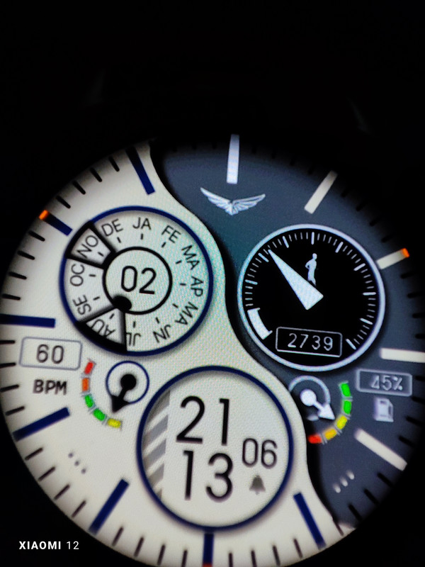

Hello to forum. Can anyone from the creators with knowledge convert this watchface exactly as it is for GTR3 Pro because sasha editor can't convert it properly. Thank you.

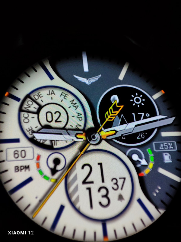

Yes i already convert it but no all functions works and months dial shows 2 months in the same time. If i had success with convertion I wouldn't ask for it. And I also did the procedure to add the user_functions.js and user_script_end.js.

Thank for you issue report about Pointer month / weekamazfitfacesafrica wrote: 02 Nov 2023, 19:14Can you convert it for me and i test it if it's ok in my GTR3 Pro. Thank you.
issue is script can not hidden Pointer
Now i fixed
you can download again and convert by yourself
Or Download this Ps.
This file cannot be converted to other sizes.
If you want to convert to another size Must use the original GTR3.
Otherwise, the pointer position (week/month)will be incorrect.

Thank you, months and day dial now works properly.
