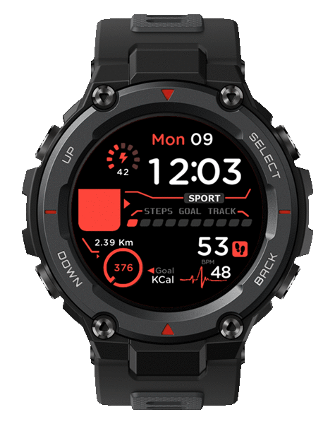

Hi @asoo ,
It is possible to convert this facer watchface for Amazfit T-Rex Pro.
https://www.facer.io/watchface/0Euok6hW ... sportblack
(* color: red, lime & cyan )
Thanks in advance.
Thanks in advance.

First of all, let me give you a little advice.
In requesting, I don't think it's a good idea, that you specific person
Because the specific person you name may not want to do that.
from your question
Yes, it is possible to port to Trex-Pro, but I don't have a Trex-Pro.
So I can't answer for sure. Will it work properly?
The best choice is You must try the operation yourself.
I see you are a "WF Maker" and look at the worked you've done. I think you can complete this screen yourself.
Anyway, I'm going to try and see what I can do with it.

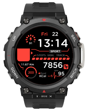

Do you have any tricks to convert this watchface to a T-Rex 2 (454x454)?
I tried converting to a custom size in the older SashaCX75 editor but it crashed.

That file ".rar" is resource and script for Watchface In the GTR2 category or categories that do not use zeppos. so you can not use this resource and script to convert
If you want to create a trex2 watch face using this resource
You need to resize all image to the size of trex2.
and bring it create a new one only, because the script in resource is not the script of category trex2
This is an example of preparation. If you want to make additional changes, Please proceed by yourself.
This is not watchface , it's only image resource and script for Trex-2
can pack and edit by use "Watch face editor for Amazfit watch on ZeppOS"
