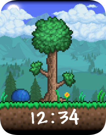

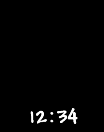

So I'm currently making a watch face for my GTS 2 using the Zepp watchface maker website.
The background is supposed to change with the weather but when I upload the watch face to my watch, the weather elements disappear and I'm only left with a black backround and the time.
I tried reducing the size of the weather images but it's still not working properly.
I also checked in the Zepp app if the weather was syncronized with my watch and it is.
Here is the watch face preview as shown on the website :
And here is the watch face as shown on the watch :
Any help would be gladly appreciated
-- edit
The weather elements didn't appear because their resolution was the same as the gts 2. I fixed it by making the images 2 px thinner.
