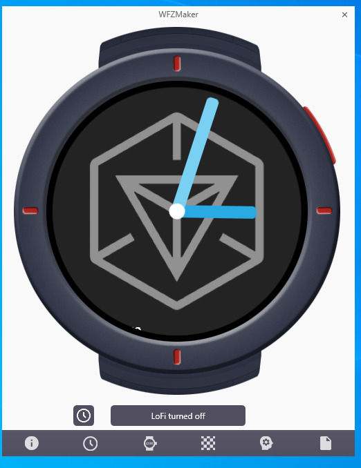

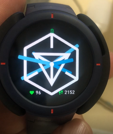

[SOLVED]
Hello guys
First of all thank u VIzzAR for the amazing tool you provided.
It's my first ever try on making a watchface and I having some problems
In the app my watch face looks like this:
But when I export to wfz it looks like this:
I have Amazfit Verge. Any ideas of what I'm doing wrong?
Thank you very much and sorry for my english!
EDIT:
I was trying to use a transparent png image as background. Once I filled the background with black all became normal.
Hello guys
EDIT:
Última edición por joaorennato el 22 Oct 2019, 14:39, editado 2 veces en total.

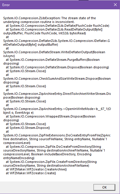

Hi guys. I was making my very first watch face skin based on The Division and when everything was ready, a big error list appeared before saying "File Saved". Yeah, it saved it, but then nothing's on screen. I tried adding a background to the numbers, I tried using different fonts, I tried no background and nothing and nothing.
I don't know if it's a bug of the last version, so I tried to download a previous one, but they're private.
Picture is attached to this post.
Any help, please? Thanks!
PS: Also, I'd love to change the colour of the widgets to make them match with the theme. Could it be possible?
